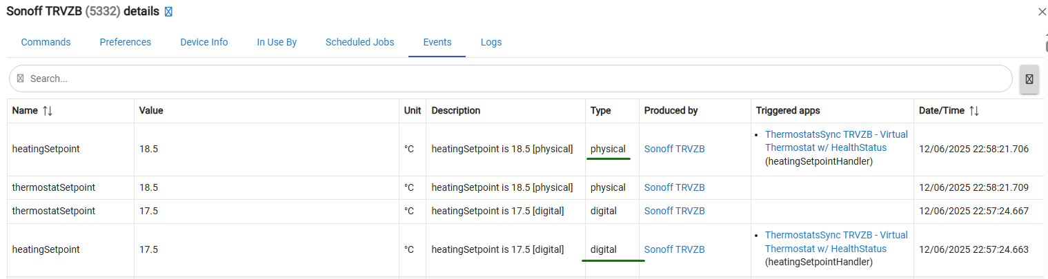

Sonoff Zigbee TRV : ver. 3.6.1 2025-12-06 (manual update) :
  • added [physical] or [digital] type to heatingSetpoint events;
The tags [digital] and [physical] in the event description can be used in RM5 rules to differentiate between changing the heating setpoint through the Thermostat Scheduler (digital) and adjusting it manually using the device knob (physical). While using the descriptionText serves as a workaround, there is currently no better method available in RM5 to achieve this distinction.
