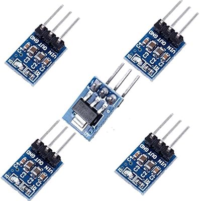

If you are going to connect to VCC, then I would recommend getting a 5 to 3.3v buck converter like this:
I've used this exact one and they perform well and you don't have to do much other than connect header wires to them. No soldering or adjustment required. But for the 4ch pro, you should be fine powering from DC. Just have to make sure the GPIO0 is grounded when you apply power, however you do it.
