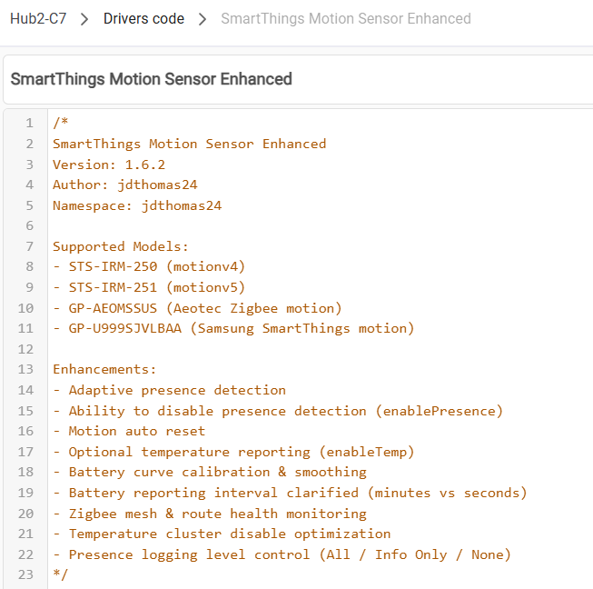

No options in the Match Up section of HPM:
Next steps? :slight_smile:
Looks to be a manual install. Previous version was 1.7.2 for auto off logging.
