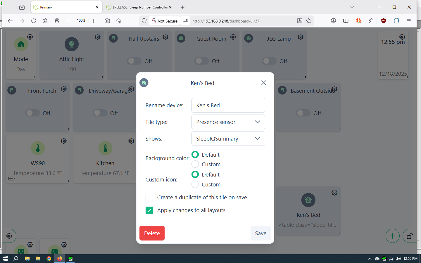

I seem to be missing a basic understanding of dashboards. I selected "sleepIQSummary" for the tile, and all I get is some HTML code. What am I doing wrong?
You need a text or html tile, not a presence sensor. Unfortunately I have no idea if you can do that with EZ Dashboards. You can with the classic dashboard for sure.
Thanks for the tip. I switched to classic dashboard and its working fine.

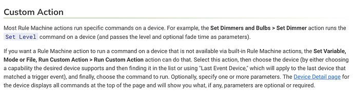

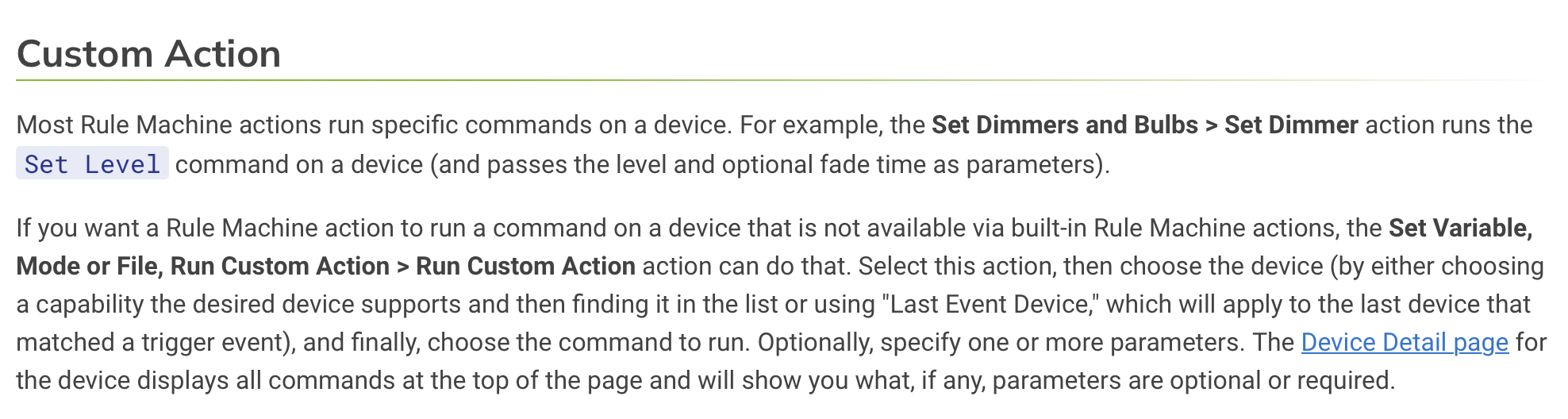

Use "getSleepData()" as a custom action in your rule. From the Rule 5.1 documentation:
I just want this to happen at a specified time, so I don't have a last trigger device. Without a trigger device, I can't get to the correct action list.
Yes you can. Using a custom action on the Sleep number device isn’t dependent on using a device as the trigger.
Yes, Got it.
I had to give it an attribute of the bed before I could select the bed from a list of devices. All working now.
Thanks for your help.

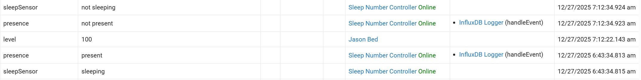

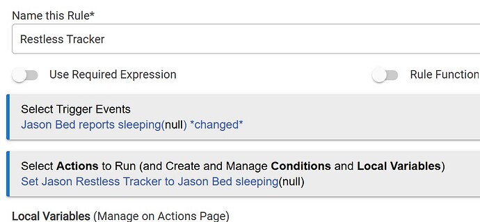

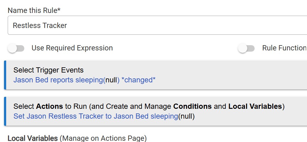

I'm trying to set a variable to the sleeping attribute of the bed but it always comes back as null even though I can see it updates in the bed events to either sleeping or not sleeping. Am I missing something?
Show us how you are attempting to set the variable.

I'm using rule machine. I see you're doing the sleepScore (which also works for me). The issue I'm having is with the sleepSensor or sleeping attribute (it's labeled differently in different places it seems). I'm trying to set it in rule machine but the value is always null even though you can see in the device events its set when it changes.
I also get "null" for "sleeping". Could you use "presence"?

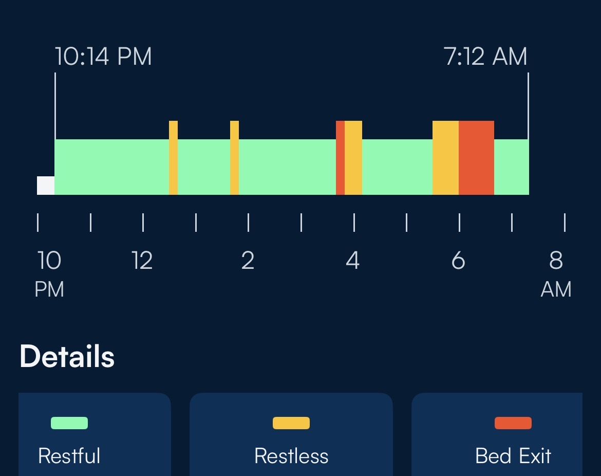

I'm trying to capture the specific times where it detects that I'm restless. So I'd be able to see I was restless from 12:30am-12:45am for example in hubitat. Then I'm going to use that information to trigger cooling automations (because every time I'm restless it's because I'm hot).

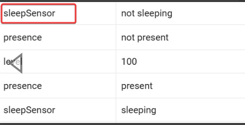

Your main issue with the null value, I can see the problem.

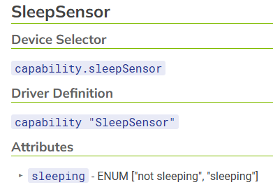

The driver itself is using the capability SleepSensor, which specifies an attribute (current state) of "sleeping". The driver also defines "sleeping" on its own, which is not needed but also harmless.
However, the driver is incorrectly trying to set the attribute sleepSensor instead of sleeping, as shown in your events screenshot.
The bug is in the library file line 100 @rvrolyk : SleepNumberController/SleepNumber_Library.groovy at 45b6270e24f612c6ea5821410c5dbea38f67bbec · rvrolyk/SleepNumberController · GitHub
If that was changed to:
@Field static final String sSLEEPSENSOR = 'sleeping'
then the Current State would populate correctly and not be null.
However, the only values you will see there is "sleeping" or "not sleeping"
