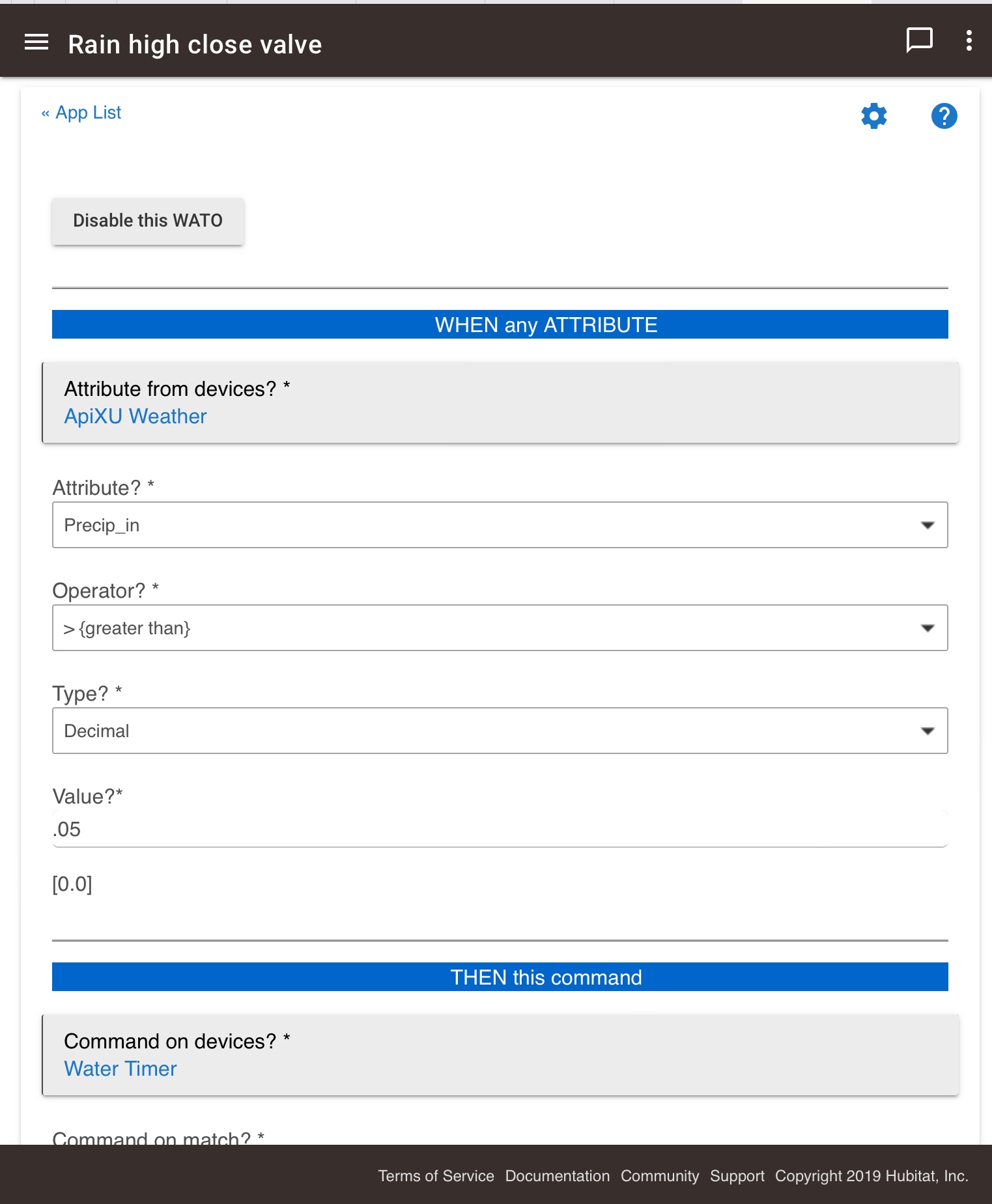

I do not have a weather station as I stated in an earlier message. Using WATO I created this rule in the screen shots. Do you see any reason why this rule would not work for me since I can’t add a virtual weather switch?

This is how I have my rain device setup in WATO... Just need it to turn a virtual switch. on/off.
Then use that device in Simple Irrigation.

One thing I noticed was your in your WATO settings is your Value?* is 0.02, and below that it is [0.35]. My second number is [0]. I am unable to change this number. the purpose of this number?
That is the actual value of the device.
Ok, looking at your logs, it didn't pass the weather check. That's why you are getting the message that your valve is off. What's the status of your Weather-Rain device, on or off? I can (almost) guarantee it's on, when it should be off.
If it is on, go ahead and turn it off so the SI child app will run. Hopefully that will also get your Wato in sync with the device status and things will run smoothly for you.
