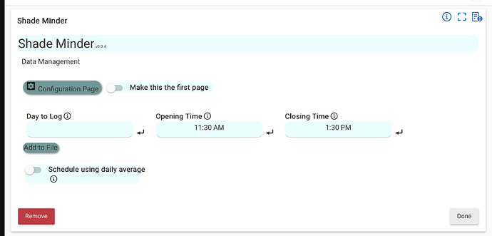

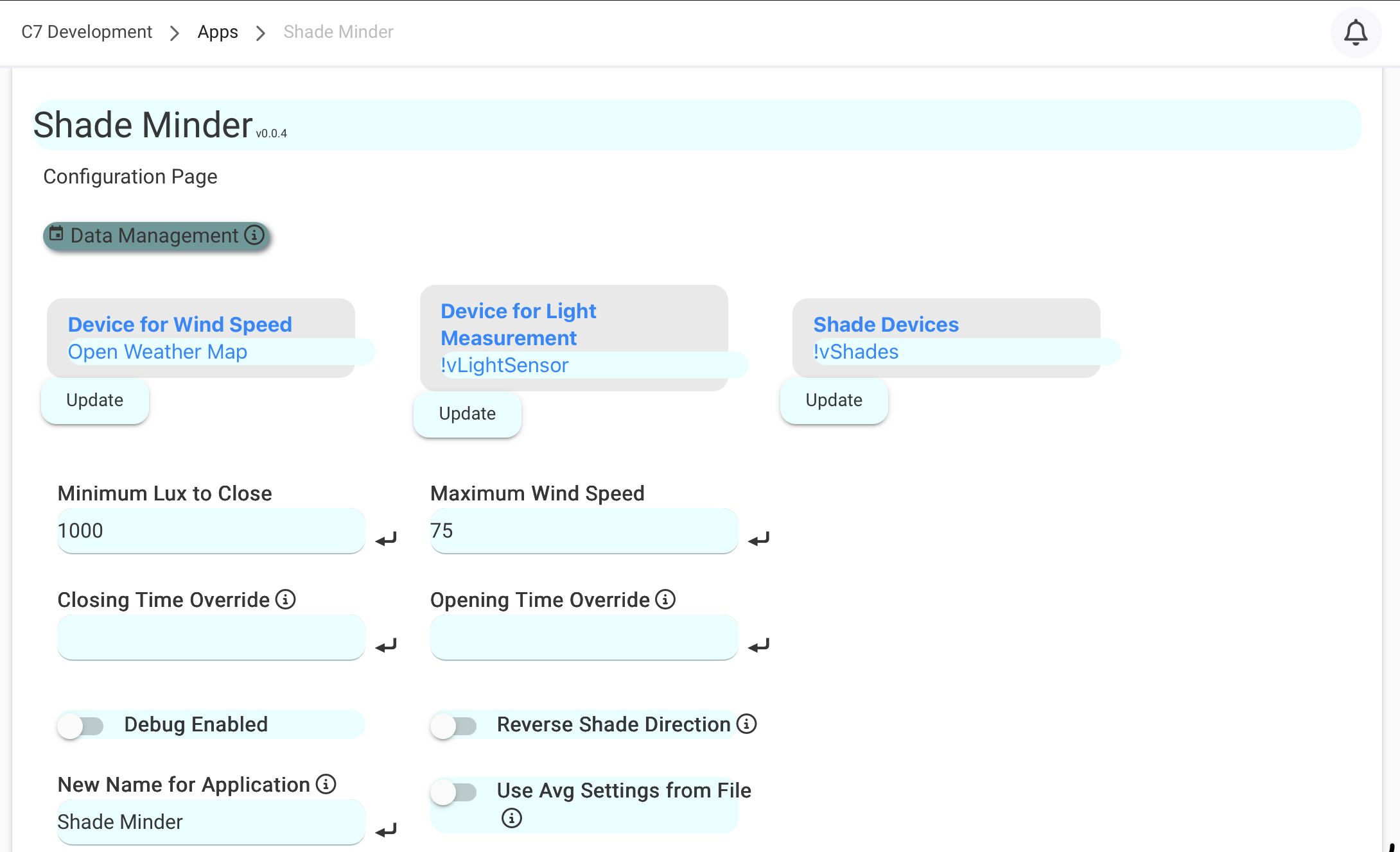

Was discussing methods of automating exterior shades and awnings the other night, and decided that the simplest way to solve the use case in question was to just write a small app. App will use luminance or a schedule to trigger operation, and if a wind measurement device is available to give windSpeed/windGust opening/closing of the shade/awning can be automated to avoid damage (10 minutes over the maximum windSpeed or a single reading or windGust ≥ 120%. of the maximum).
Schedule is based on the Julian Day (001-366); any mulitple entries for a day are averaged. Days without an entry will use the closest previous day entry average. Can also use a simple set of closing/opening override times.

This app is exactly what I'd been looking for! Having each of my outdoor shades to be controlled using time triggers based on user-observed data provides the ability to customize opening/closing times at a very granular level.
In my specific case, my two shades need to open/close at separate times, due to the angle of the sun. Also, those times change significantly due to the movement of the sun, but also due to the occlusion of the sun by trees and my neighbor's roofline.
This phenomenal app allows me to enter times as conditions change, then the app calculates times in between my data points. The more data I collect over time, the more accurate my trigger times become. Brilliant!
I can't thank @thebearmay enough for his time, expertise, and community-minded spirit!! I've been trying to solve this dilemma for months and he flew in like Superman and crushed my problem. The Hubitat community is excellent and I appreciate support from @sburke781 along the way as well. Thank You!!
