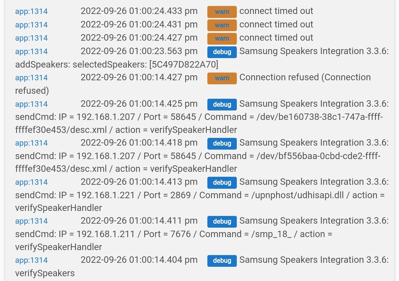

I have had your integration of the Samsung speakers (R1) for a couple of years and it was my most reliable Hubitat speaking device. But it seems to have dropped off and I can't figure out what's wrong. Now on 3.3.6/3.3.8. Here are some logs. If you have a moment, would you look to see what I'm doing wrong?
Check to see if you can control it from the Samsung Multiroom App. The messages indicates that something has changed. Maybe IP address or something else in your router setup.
If it continues, uninstall and then install is the only current option.

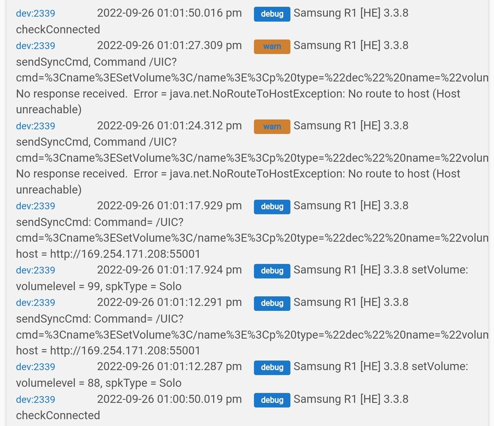

The Multiroom app does see this speaker. But I think your tip about the IP address is on the right path. It looks like my static assignment in the router had dropped off and it was getting a random dynamic IP. I don't see a way in the app or driver to change the IP of an installed speaker. Is this possible? I'd prefer not to uninstall everything because I have about 20 rules that reference this device. Thanks again!
I added the 7 lines of code to allow resetting the IP address in preferences. This is a "test" release and the changes will be incorporated in the next formal version. (I am currently using this test version.)

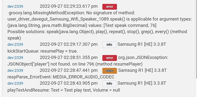

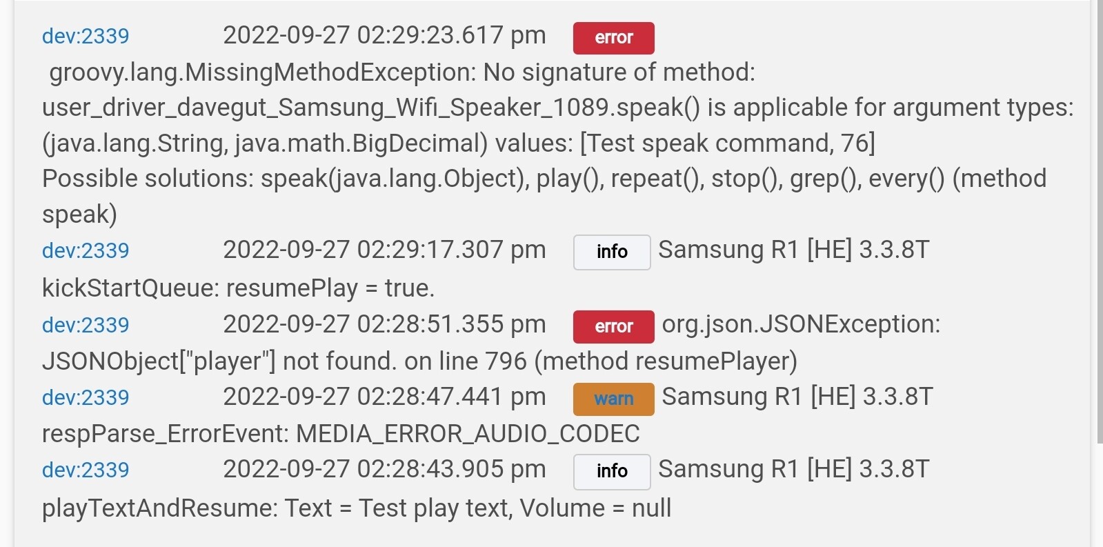

It definitely changed the IP because i can see it in the driver and testing from RM and the driver works. Since it works, it may be just a curiosity, but commands from the driver also generate errors in the log:
Top error. Hubitat has changed the Speak specification and I need will have to update to take the newer parameters.
lower error. Not sure at this time
Warn. Your speaker did not accept the audio format that was generate by the Hubitat TTS command (with uri generated by Amazon)? They used to accept this; however, over the years, things change. Try play text and resume again and tell me if it occurs again. If so, I will provide access to the VoicesRSS codex that works (code is already there for the soundbar).

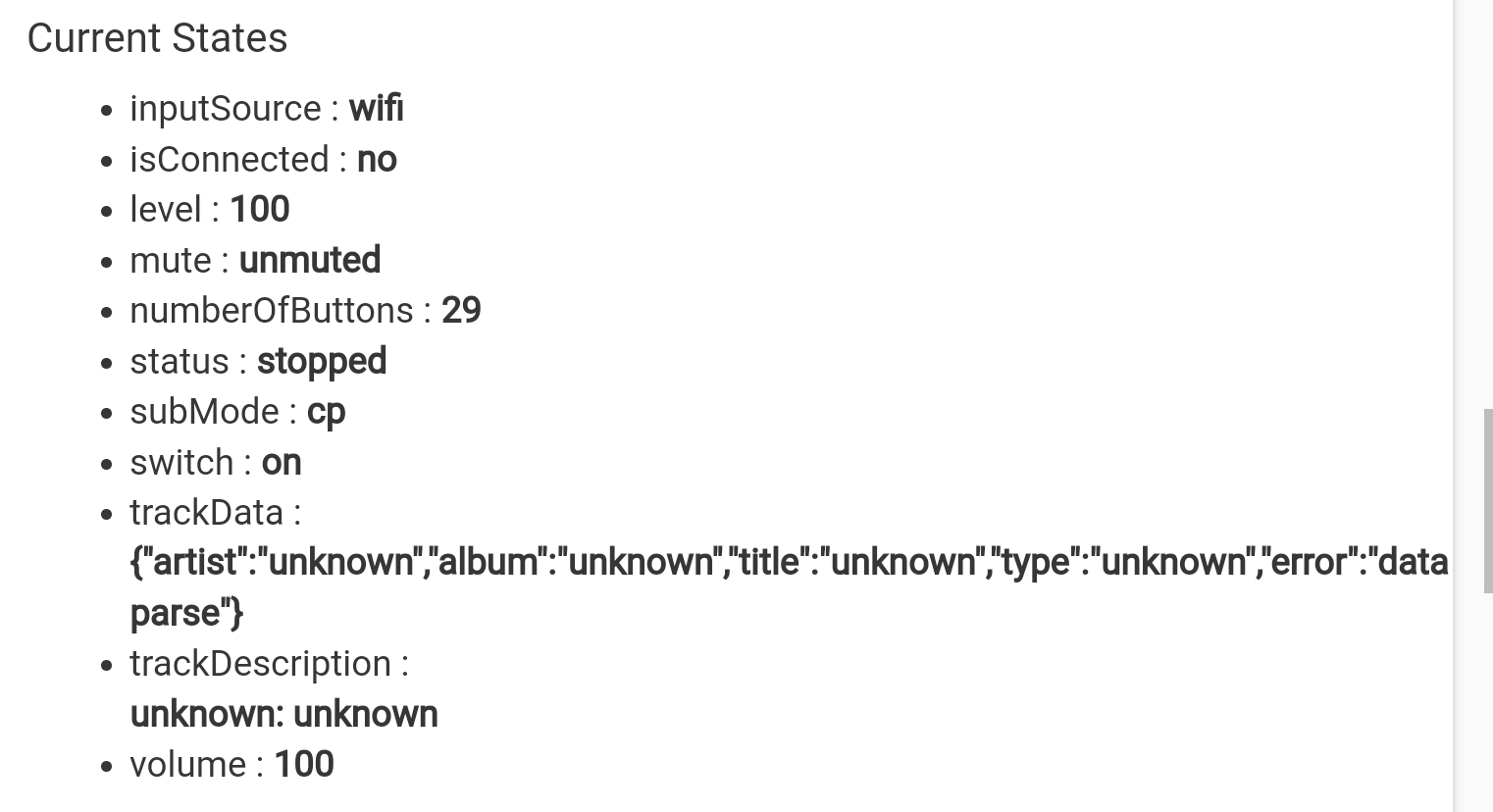

I love your app and have been using for a couple of years. However since the upgrade it has stopped working. I have saved preferences. Any suggestions appreciated.
First thought is to check the data value "deviceIP" in the devices page "Data" section versus the IP address in your router. If not the same, run the application again (It will attempt to update the IP address). Final solution is to reinstall.
PS: Make sure that the Speaker has a static IP address assigned in your router (see the instructions).
Thanks for the quick response. I tried everything including full reinstall. It finds the Speaker but the IP’s continue to be different (speaker and router) Any help is appreciated.
