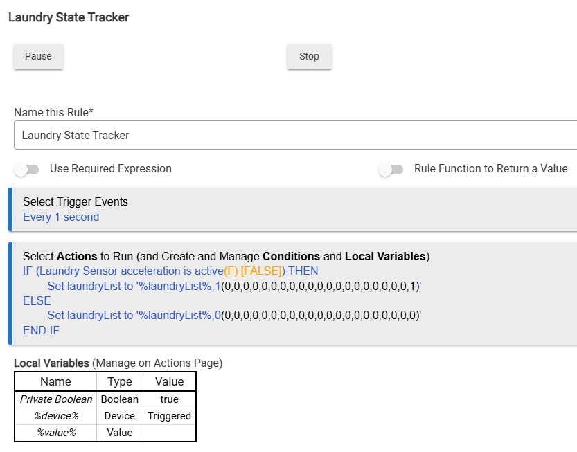

First, set up a periodic rule in Rule Machine, at the desired interval. You can either have it append your numeric sensor value directly to a list variable, or—as shown below—if the sensor has different states, record them as numeric values (like here, my acceleration sensor is either "active" or "inactive"):

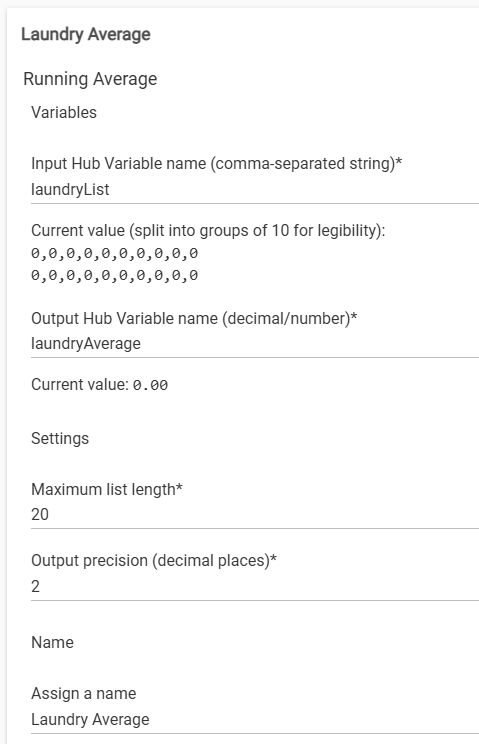

Create a new instance of Running Average; specify your input variable name (the list variable your rule saves to), and then an output variable to save the average to. You can also specify a maximum list length: this, times your interval in your Rule Machine rule, dictates how long the average is taken of (e.g. 3 seconds × maximum length 40 = 120 second running average).

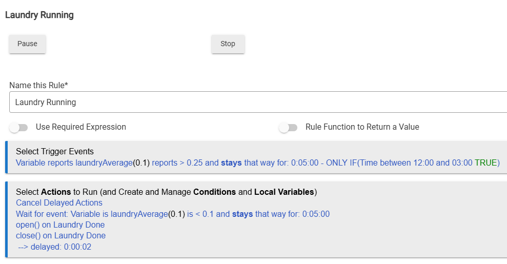

To use it, just make another rule based on the output variable, like so:
