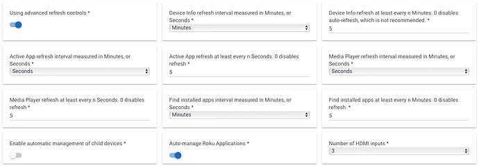

Hi Armand, Thanks so much for creating this great package. Loving the integration and capabilities but am stuck on the Query Active App refresh time. Is there a way I can set this to automatically run ever x seconds. I am trying to use the app buttons on my roku remote to trigger Rule Machine but it seems like I need to run the query manually each time. Thanks!
This is what I use:
Summary:
  1. enable advanced refresh controls
  2. set Active App Refresh interval measurement to “Seconds”
  3. set Active App refresh every n seconds to your number of seconds.
I highly recommend setting media player to the same or faster interval as app refresh. The reason being is that once media is playing, app refresh is ignored in favor of media player status updates, and only when media player stop does app refresh resume. Setting media player to same or faster interval ensure the same experience.

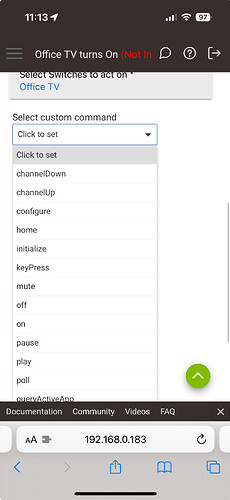

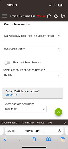

I am trying to do some very basic things. Turn on the TV - which you see in the rule. And then after the TV is turned on to set the input source for the TV. Normally I would expect to use Run Custom Action, then Actuator, then select this button and specify a string to pass to it. But maybe I have this all wrong? Thanks for the help.
Here I created a custom action…
And after doing all this, I can select the custom action.
When you select the device type in the action, that is just a filter. But when enumerating the available actions, they are all listed for the selected device.
I just noticed, this is a legacy rule you are using. Please switch to the modern rule machine. The legacy rules are just there for backwards support. There may be a bug in it that is preventing the full functionality.
Make sure your hub is up to date as well.
It is the latest rule machine. But I found it. I didn't realize you have to select custom action, then switch, then custom command. When I have used custom commands such as this in the past I have selected Run Custom Command, then actuator, then custom command. To be honest I don't really understand the difference between the two?

I just started playing with it but my first question would be how often can I refresh without killing the hubs cpu? I’ve got 5 Rokus I’d like to monitor. Looks like everything I want to do can be done by looking at just the application that’s runnning. On 2 Rokus I’ll look at transport status for pauses. Every 5 seconds be ok maybe?
That’s a tough one to answer. It depends how you use it. I recommend you turn on advanced refresh. I have mine set ton5 minute device refresh, 5 second active app refresh, 2 second media player refresh and 30 minutes for installed apps refresh.
I don’t trigger events based on if the atV turns on or off, so every 5 minutes is enough for me. You can safely go down to every 5 seconds just fine. The thing is, if advanced refresh is enabled, then the device refresh is just for detecting when the tv turns on. Once the TV is on, the much more efficient active app and media player refreshes are sufficient.
