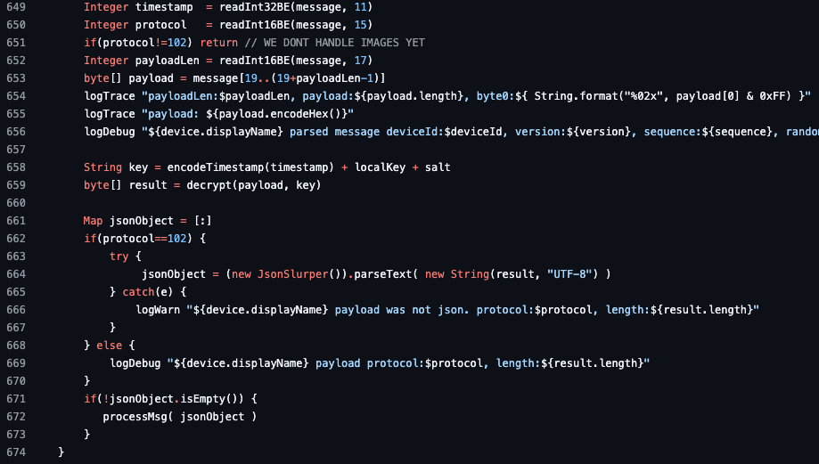

Update:
If you want to give it a go, you can see at line 651, I block on messages other than 102. The images are different type and I think have different encryption, but I didn't take it much beyond just blocking from processing since I didn't want the load on the hub.

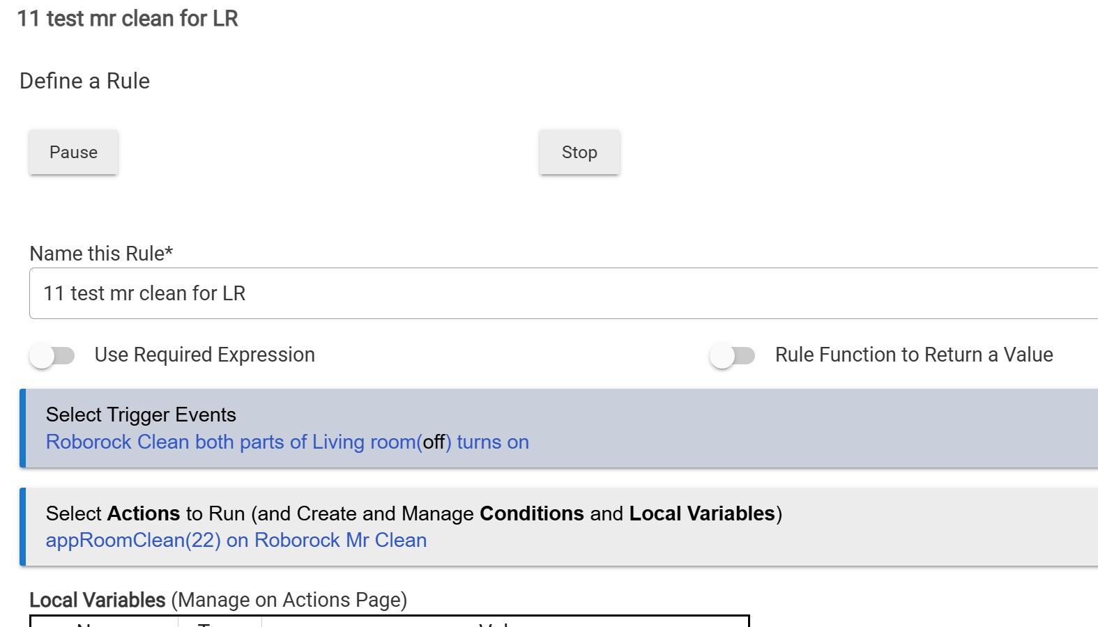

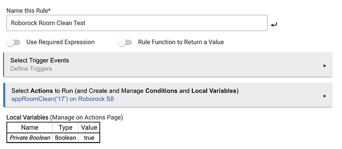

First off, MANY thanks Bloodtick for creating this driver. I just bought my 2nd roborock 3 days ago - and a buddy told me about the driver ... I WAS using Home Assistant but now am switching over to your driver.
I cannot for the life of me get a Rule machine rule to execute for the vacs though. No PROBLEM doing anything on WebCoRe - my testing just uses a virtual switch then I attempt to have RM do a appRoomClean for room 22 I am trying the following
Here is the very short rule I am trying to make work - room clean for room 22 if switch turns on
I have no problems inside the driver by inputting room # in the App Room Clean portion of commands - it works right away. I am trying to do this programmatically in RM ... and also, ZERO problem doing this in Webcore.
Feeling stupid ...
Ensure the input room parameter is a string. I am not seeing 'ticks' around it in your example. It was a weird workaround for other reasons. So don't feel ....
