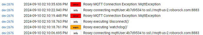

Released 1.1.5 update to hopefully address an odd de-authorization from the mqtt that requires a fresh login. It would show in the logs as:
There is now a preference that should attempt to login again after # time when this happens, and is configured here:
The rate for a new login is limited (not sure what that is exactly), so the minimum time allowed is 15 minutes to prevent problems.

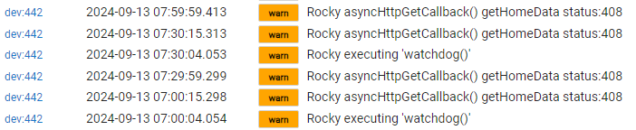

Have two hubs failing again on 2.3.9.180. Had to reboot them to get the driver working. Was calling a 408 Request Timeout error on both from an asyncHttpGet method. My network is stable and this driver hasn't been changed in some time. Something has changed (I think since .177 but might be a version or two sooner).

That is four different hub failures now on 180. This driver uses the mqtt interface, which might be still might be the problem and exhausting the TCP stack. LMK if I can give you some type of debug or hold a hub broken (I have a dev one) for inspection next time it happens.
@gopher.ny failure (408 Request Timeout asyncHttpGet method) again after less than 24 hours on two different C7 hubs running 180. Again this driver hasn't changed in some time. Something happened between 166 and 180 that broke. Again the this is mostly a mqtt binary solution that has some asynchttp methods for other metadata. Only thing that solves is a reboot of the hub.
The mqtt socket fails first and will not reconnect (by design) until the http stack returns good. Then the http stack starts returning 408s until hub reboot.
This is the param map sent to asyncHttpGet:
[uri:https://api-us.roborock.com, path:/v2/user/homes/191152, headers:[Authorization:Hawk id="4PP....Pmj", s="4...T", ts="1726313338", nonce="9254a23e", mac="U/Qz6....ik="]]
It 'appears' that DNS to that https site is in a failure mode for this driver? (just guessing).
