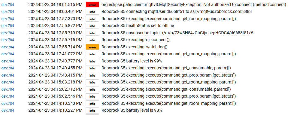

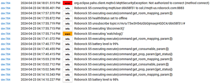

While watching the logs to see it refresh on a battery rise, I hit refresh and it said it was now at 99%, but then the log reported "Roborock S5 battery level is 99%", Then it executed watchdog(), it went offline, and I got that error that requires removing the device to fix. Debug logging had turned off at that point, unfortunately.

I am curious why the device lands in the failed state that requires setting up a whole new device. If there is a limit, my refresh each minute could add up quick on a longer cleaning. I have been testing with a small room for convenience of not waiting long for it to finish.

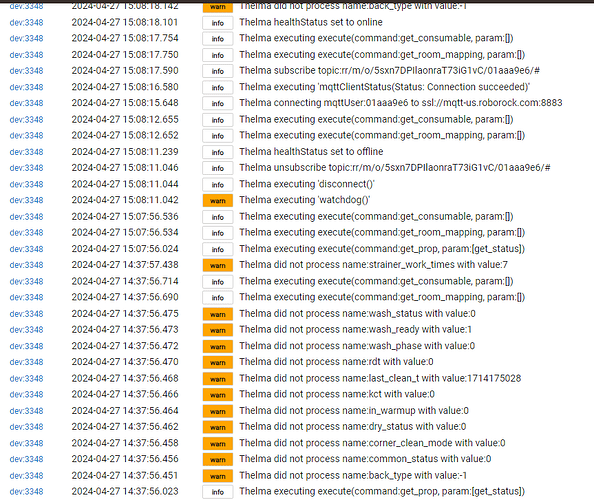

After watchdog ran is when I got the error. What is the need for watchdog? It seems to disconnect and reconnect, but the reconnect is where it appears Roborock ditched responding. Not all refreshes seem to call watchdog. getHomeData() seems to be called in many other places besides watchdog, but it seems to fail only after watchdog does the disconnect.
Is it a collision of watchdog getting called by the device timer, and me hitting refresh manually (or by my app) happening at the same time? That seems to be when the error happens.
The watchdog fires if you send an MQTT command and nothing returns within 15 seconds. Normally, this shouldn't ever happen when things are healthy, but the MQTT drops offline at least once a day, I have found. When that happens, I need to clear and refresh the MQTT connection and subscription.

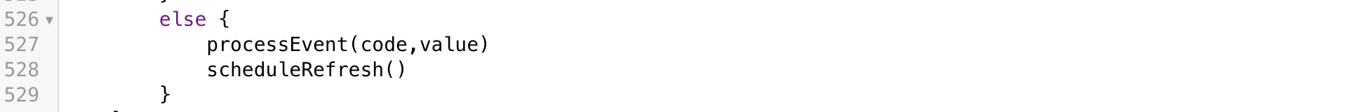

If you notice, the 'scheduleRefresh' command sends as a 'type:2', and that doesn't invoke 'getHomeData()'. But using the normal refresh sends as a 'type:1', and that does invoke the command, which is a bigger refresh and obviously needs semaphore protection since the UI, HTTP, and MQTT are all running separate threading.
I'm not sure why your device requires a reset when that error happens. If you do a full login again, does it start working? Or does it require a delete/add in the mobile app?
My thinking at the moment, if I see a real time battery event to operate like it does today. If I don't see a real time battery event to schedule a 60 second 'soft' refresh when the state is not 'charged', which should do the same thing you are doing. (and protect that soft area with a semaphone)
I think I have tried everything to get it working again after the error. Initialize, Change driver to Device and back again. Change driver to Device and clear all states, and switch back again. I also Initialize after the driver is changed back.

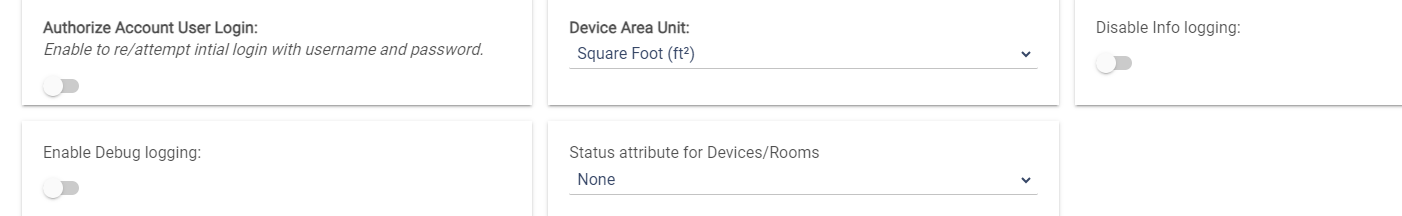

I noticed the setting called "Authorize Account User Login" I tried enabling that but that does not help either (not sure what that even does).
So yes, I have to delete the device and create a new one, as that seems to be the only thing that works.
This will start over with username and password and wipes everything. There is a quick limit on number of times per minute (if even per minute) logging the first time. But you need to hit save preferences of course to try the login after you enable that setting.
I was able to duplicate your error, and did recover using a complete login. Pretty sure this is a limit on the number of times you can hit the https service. I am putting a limit in to only allow 'getHomeData()' once every two minutes, so your solution would/could work. Also put in a autoRefresh check and if I don't see the battery automatically dps refresh, will do a refresh every minute during certain states.

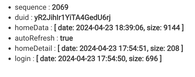

If you see 'autoRefresh' in the state section, the unit does see battery real time updates and I disable the 'workaround' refresh.

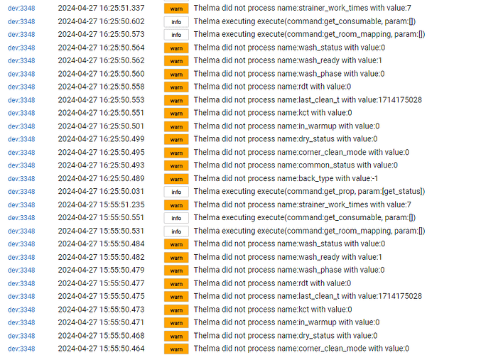

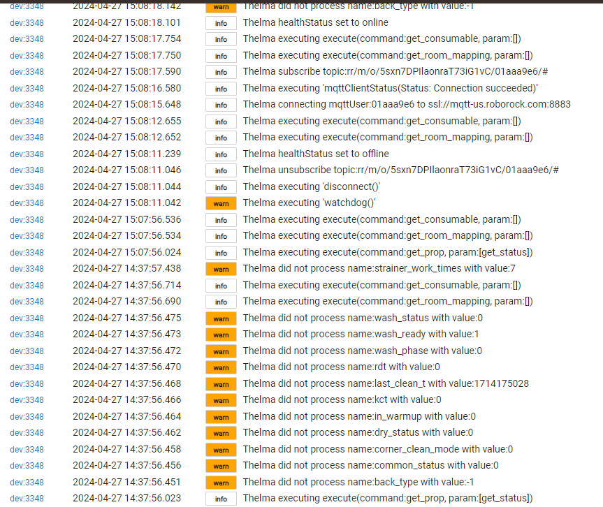

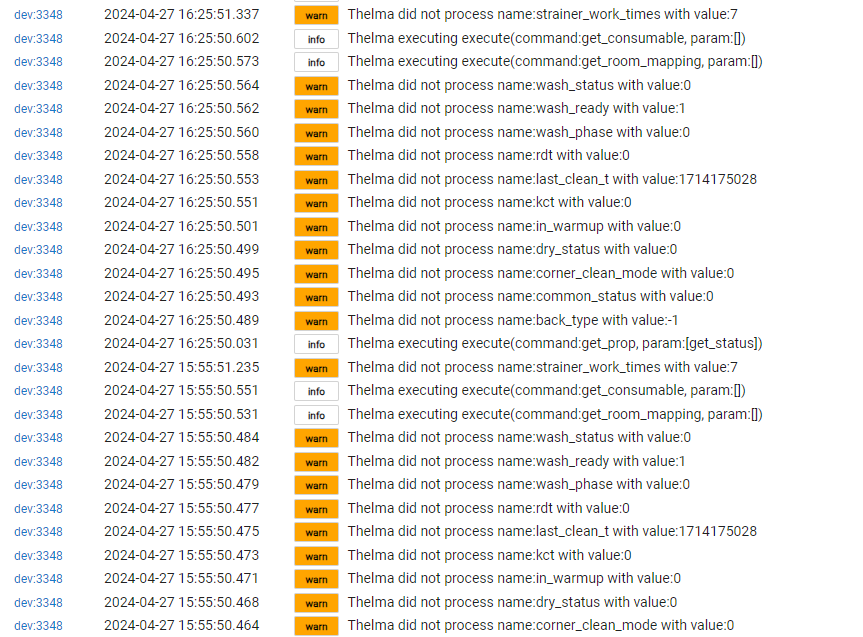

I have the Q Revo with the dock and I am getting these blocks of warnings:
Can these errors just be ignored?
The vacuum is just sitting in the dock "resting". Thelma is a lazy B and doesn't get out much...
