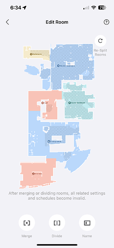

I think you need to name the rooms for that data to populate. This is how one of my maps look with the names. I had a older unit that was the same (and oddly the rooms are still in the homeData).

Ahhh. I forgot i was editing the map and i don't think i ever renamed the rooms.

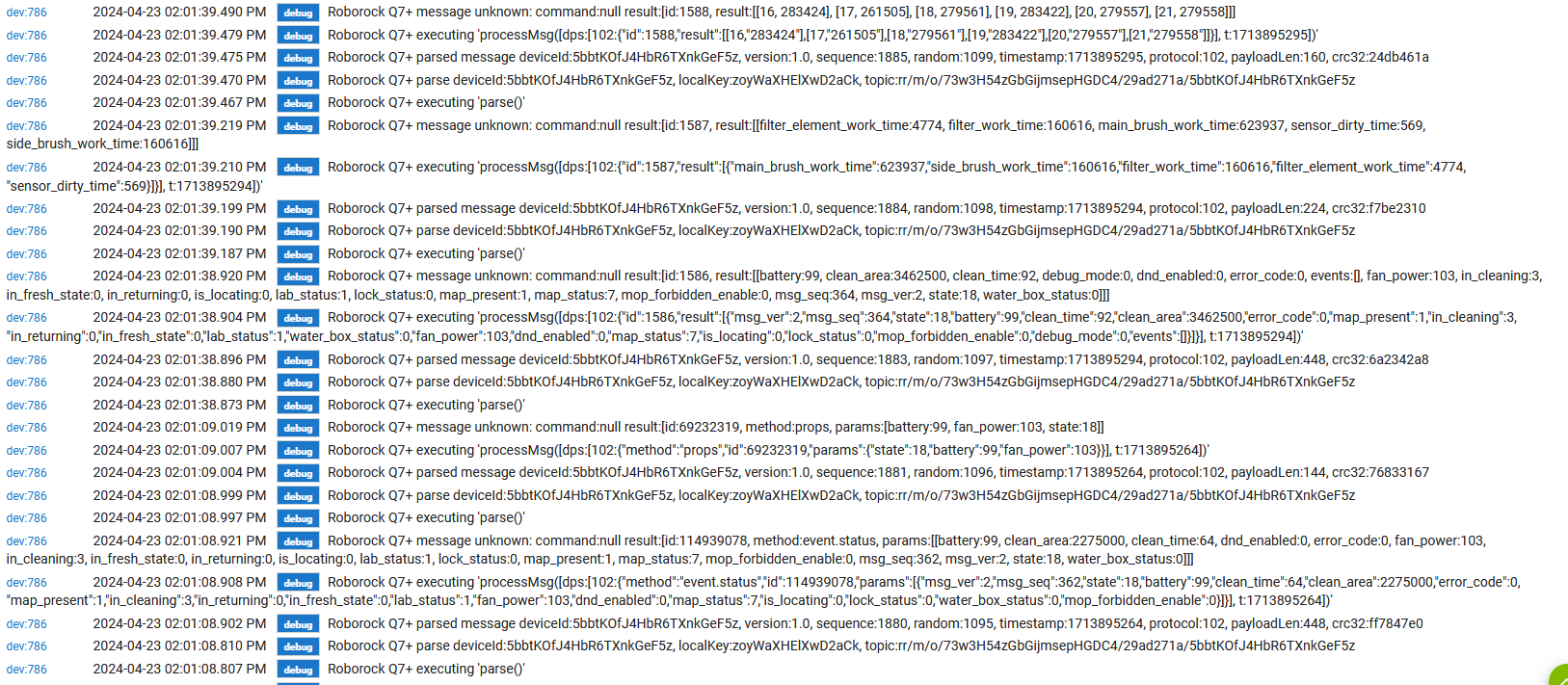

When both vacs are idle, and I hit refresh() in the S5, this is what the Q7+ device logs:
Thanks. I see what is happening and will be able to patch that quickly.
Thanks for sending the debug. Update line 560 adding this:
if(deviceId!=state.duid) return
and please retest.
Edit: I pushed patch 1.0.2 to github if you want to just test that. It was obvious in your debug!
Yes, that stopped the double refresh! I was staring at the parse() method trying to figure out how to fix it, now I see it is being called multiple times on refresh(), so your fix is to just bail on the vac that was not the vac id that called it.
