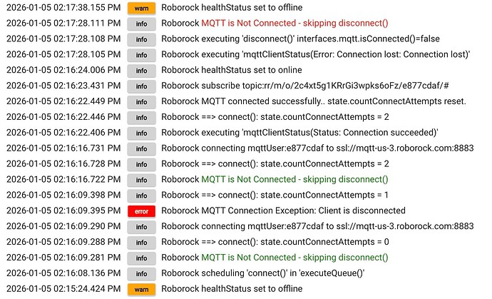

Sometime after I re-authenticated using 2FA, I find that the MQTT connection keeps getting dropped within a minute of the vac going idle. The driver then reconnects, but the connection repeatedly gets dropped thereafter.

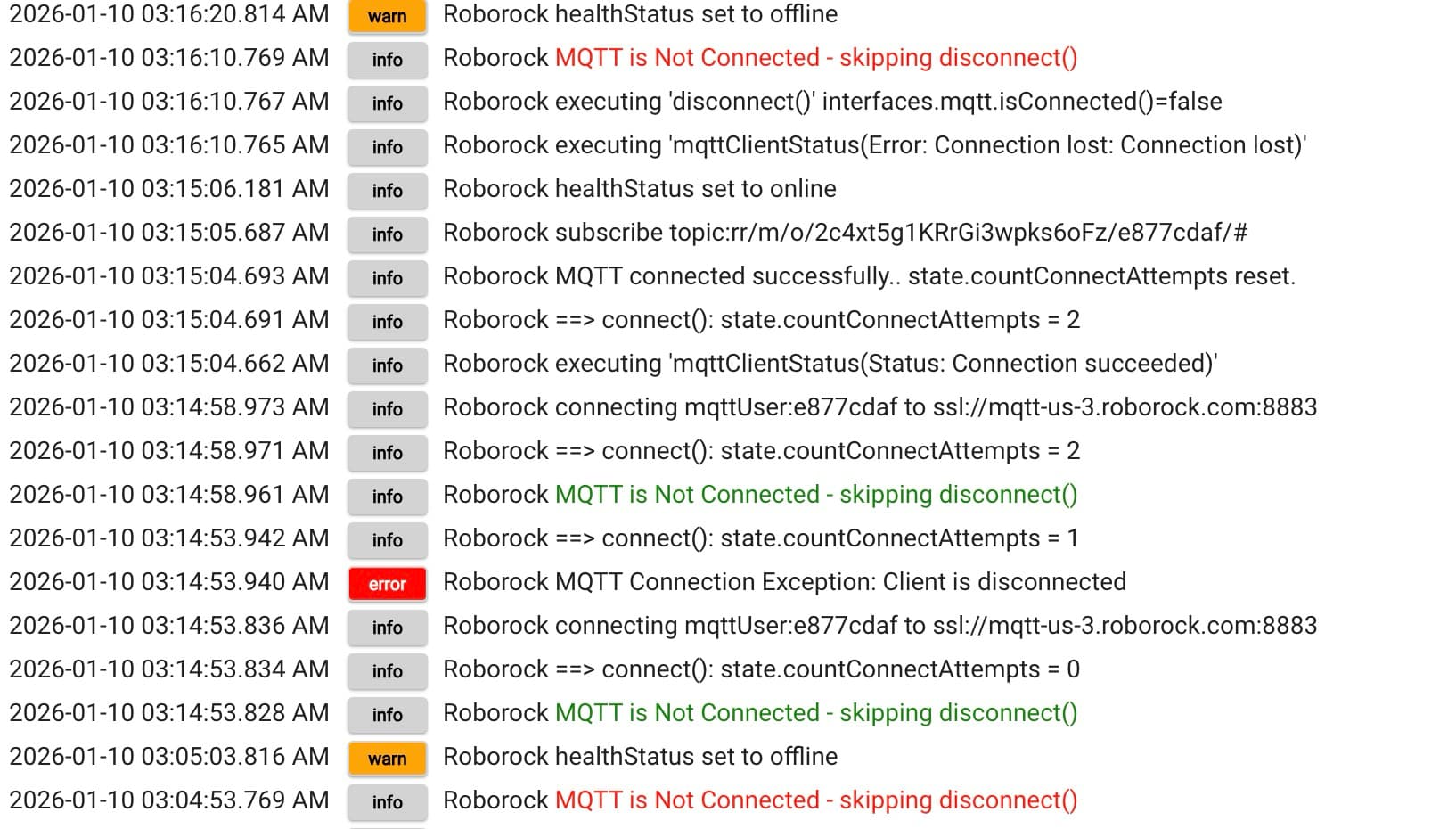

My logs are just this repeated all day long:

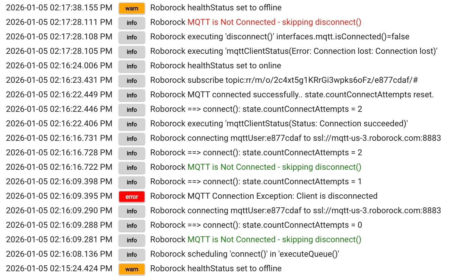

This is right now after I ran the vacuum and told it to go back to the dock. You can see the MQTT connection dropped 1 minute after the vac went idle:
:white_check_mark: Yes, me too. I thought it was only an issue with my Roborock CurvX model. The Roborock iOS app appears stable when I check it. I believe the iOS app resubscribes to their MQTT servers at mqtt-us-3.roborock.com:8883 when the Roborock iOS app is launched.
I modified the Roborock Robot Vacuum driver to auto-retry connecting twice after an MQTT disconnect. After two connection attempts, the driver exits and waits for the scheduled job to refresh.
One could achieve this same reconnect logic using an HE Rule to detect when the driver's health status attribute is offline and then command the driver to Refresh. It would be wise in the Rule to check how many times the Rule retries to avoid creating an endless/runaway loop.
I have not been able to determine why the disconnect occurs, as other HE MQTT-based app connections are very stable.
My driver workaround is a temporary fix until the Roborock Robot Vacuum developer can investigate and recommend a more permanent solution.
warn Roborock healthStatus set to offline
info Roborock MQTT is Not Connected - skipping disconnect()
info Roborock executing 'disconnect()' interfaces.mqtt.isConnected()=false
info Roborock executing 'mqttClientStatus(Error: Connection lost: Connection lost)'
info Roborock healthStatus set to online
info Roborock subscribe topic:rr/m/o/2c4xt5g1KRrGi3wpks6oFz/e877cdaf/#
info Roborock MQTT connected successfully.. state.countConnectAttempts reset.
info Roborock ==> connect(): state.countConnectAttempts = 2
info Roborock executing 'mqttClientStatus(Status: Connection succeeded)'
info Roborock connecting mqttUser:e877cdaf to ssl://mqtt-us-3.roborock.com:8883
info Roborock ==> connect(): state.countConnectAttempts = 1
error Roborock MQTT Connection Exception: Client is disconnected
info Roborock ==> connect(): state.countConnectAttempts = 0

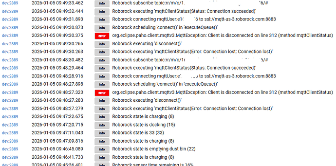

Rebooted the C8 hub, but still seeing disconnects after 1-2 min...

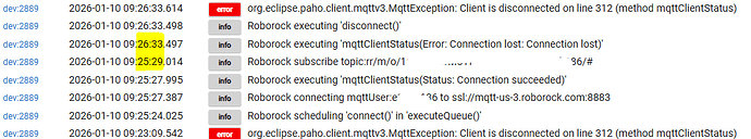

I have highlighted the log lines showing MQTT disconnects. It looks like the Roborock MQTT is getting a "Client is disconnected" message when trying to re-connect?

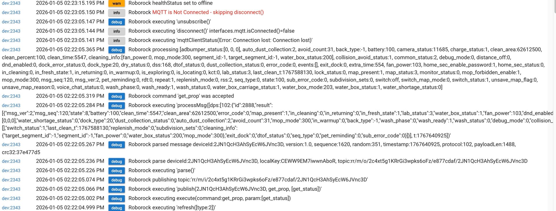

Here is more log info from debug
I did just update my hub (C-7) to the latest beta release, and these disconnects were still happening afterwards.

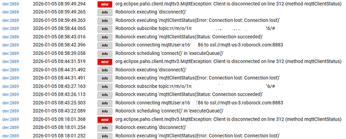

Yes.

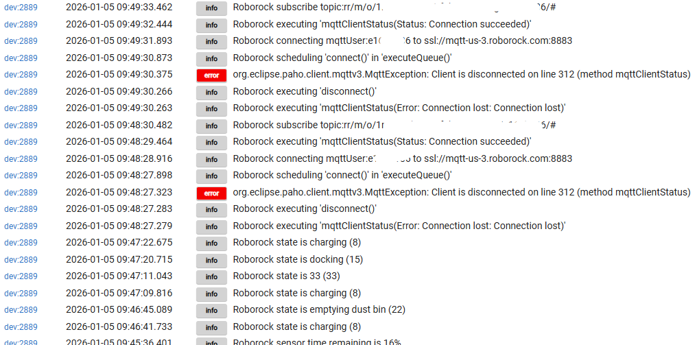

Yes. It looks like the MQTT connection is getting dropped after a minute:
