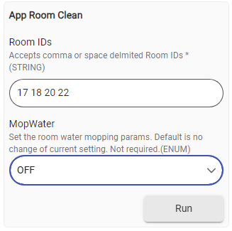

Trying to start the my S7 with Rule Machine but with only certain rooms AND mopWater turned off in case with forgot to remove the mop. If Only send room codes, all works but since default is to use the mop if installed, it will start the mopping function. When I try to add the second parameter, it just does not work. I tried everything i could think of like string OFF, string and integer 200 (code to turn off), string MOPWATER=200, etc. it just does not start when adding the second parameter.
Here is a snippet of the code, it does trigger the notify if I place it before the appRoomClean command so it does trigger, did not see anything in the logs.
Next option if no one can help or find what I'm doing wrong is to add logging in the code to see what exactly the appCleanRoom receives when I use via the commands (just thought of this option and will do it tomorrow when back home)...
The second parameter is an enum, so you should use "Default, Off, "Low",...
So it this case, would expect the command to be:
appRoomClean('17 18 20 22', 'off')
It shouldn't be case sensitive.

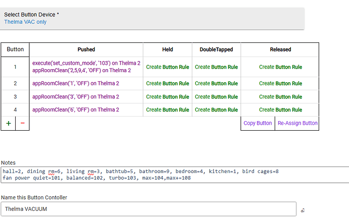

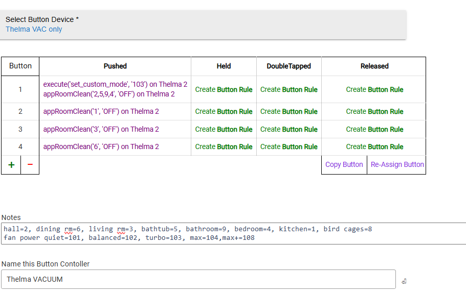

This is what I have so far for my Soros 10R.
All commands are vacuum only and the Soros can leave the mop pads in the dock.
The set_custom_mode is for fan power and 103 is turbo.
Seems like most of the commands are common to many of their "later" vacs.
Kind of trial and error.
