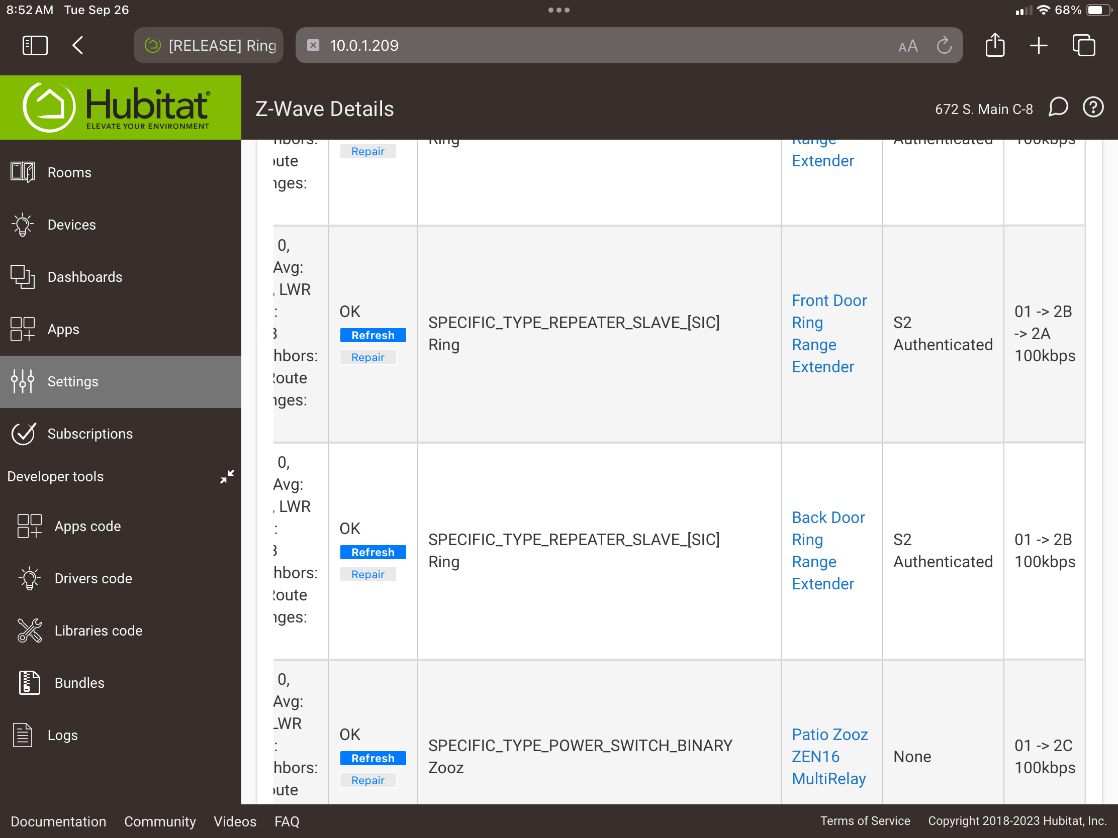

What hub do you have? Is the Ring Extender Gen 2 paired S2? Need C-7 or C-8.
Using @dennypage one
C8
Then, if it is paired S2, only thing I can suggest is to exclude and re-pair. I have 6, they all work perfectly with @dennypage’s driver if paired S2. Worked fine on my C-7 and now on my C-8.
I don't know if it is paired S2 or not. Not sure how to tell at this point.
According to settings it has no security.
Settings, Z-Wave Details.
S2 shouldn’t be needed, but the Ring Extender V2 is funky about this. There was a big discussion about this when the product was introduced. @bcopeland, who wrote the built-in driver, said he never could get it to work properly unless paired S2.
I would suggest excluding and re-pairing.

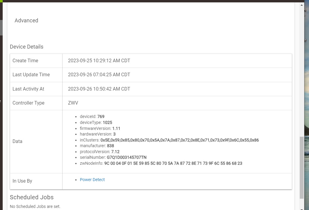

Something is wrong. Can you post a screenshot of the device page please? Please include the Device Information and Device Details section. Thanks.
