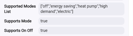

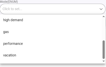

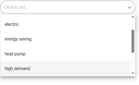

I swapped my 2017 era heat pump water heater [Generic Type heatpumpWaterHeaterGen4] to this driver from Kris's driver.
It detected the water heater, and it controls the water heater fine. It seems very responsive to commands, the water heater switches modes and temps correctly from what I can tell.
The only thing I see is a discrepancy in commands available in the State Variables and the Set Water Heater Mode dropdown. The State Variables IS correct for my water heater, the dropdown has things that do not apply namely Gas and Performance. Vacation also doesn't seem to do anything.
I wonder if these items could be filtered or hidden in the dropdown?
Other than that, I would call this driver a success!
