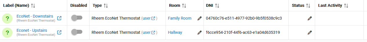

Sorry for the delay, I finally got around to stepping through this.
At present I don't ever get prompted for the Econet login, as I did previously.
what I did was removed any instance of the drivers and the "app" install from the HPM. (yes I understand now its not an app).
I followed the steps from the Git and what you have above, but never get prompted for the econet login.
and since it didnt prompt for the login I am assuming that is why it has no info on the commands page.
I have stepped through it 3 different times. Once using the HPM version and twice using the copy paste from the github
as before, your time and insight are appreciated.

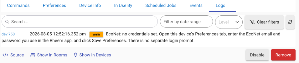

Thanks for sticking with this and for the screenshot. That told me exactly what happened, and it's a gap in my instructions rather than anything you did wrong.
Good news: your devices should be fine; it appears both were created correctly. There's nothing to remove or redo.
There is no login prompt. That's the part my README never said. Your EcoNet email and password aren't something the driver asks you for β€” they're settings you type into the device itself, after it exists. Nothing pops up, and until you enter them the device just sits there with no data and a ? for status, which is exactly what your screenshot shows.
I've also pushed v0.2.1 so nobody else has to guess at this. A device with no credentials now says so directly in the log instead of sitting there silently:
To finish your setup:
  1. Open EcoNet - Downstairs, go to the Preferences tab, and enter your EcoNet Email and EcoNet Password β€” the same ones you use in the Rheem EcoNet app. Leave the serial number blank and click Save Preferences.
  2. Do the same on Econet - Upstairs. Both should populate temperature, mode and the rest within a few seconds.

If anything doesn't look right along the way, the Logs tab is the place to check β€” a wrong email or password gets reported there.
