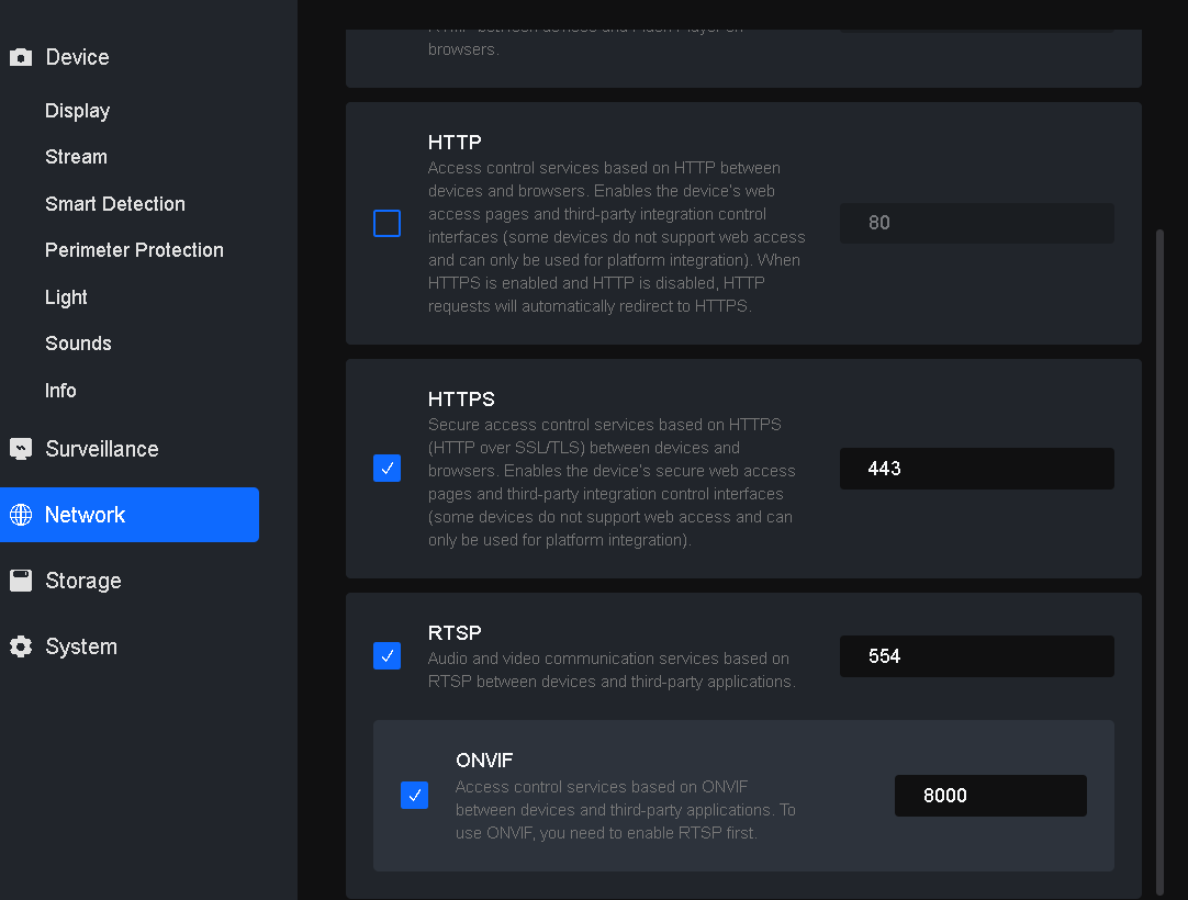

The line 413 error is Hubitat throttling the app for overall load, not a bug on that specific line, so I'm looking at why the app runs so often on your setup. My suspicion is that polling isn't being skipped on your standalone cameras even though their event connections are up.
Two things would help:
  1. Which camera is source 9 (model and firmware), and does the reconnect loop only happen on that one?
  2. As a temporary workaround, try raising the poll interval on each camera device's Preferences from 3s to 30s, then check whether the load drops in Performance stats after an hour or so.
    3.Full debug logging from the integration. (Only a short window and put back to Error only)

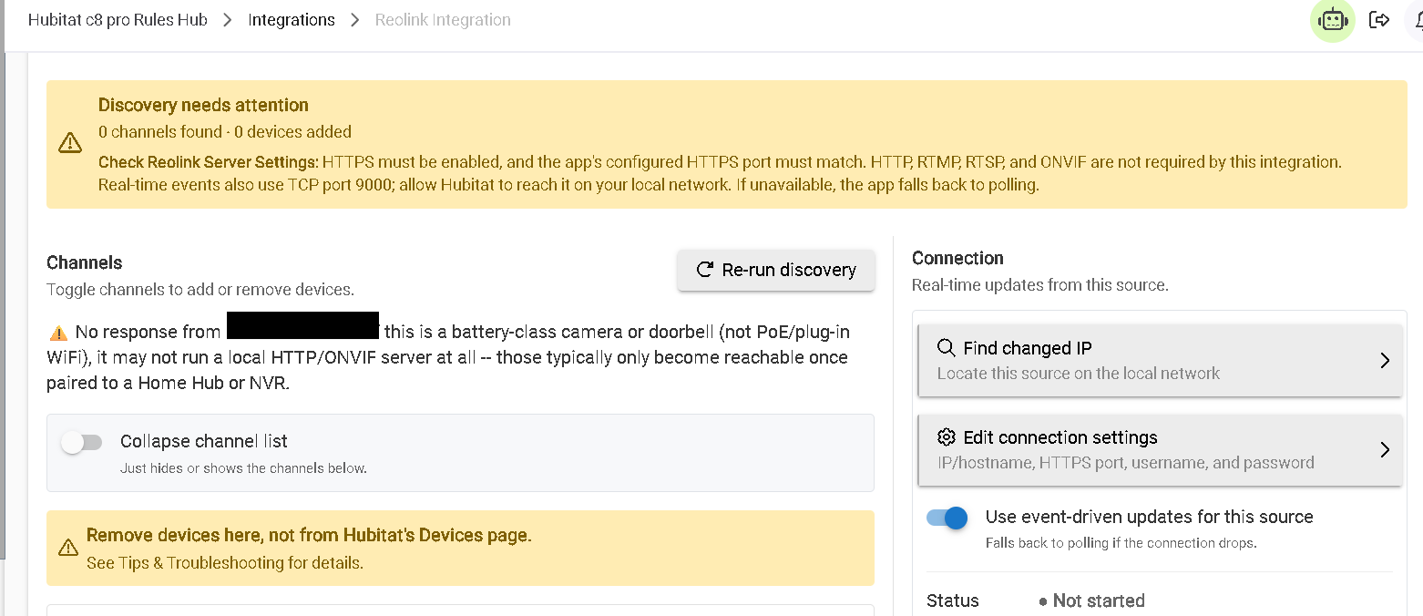

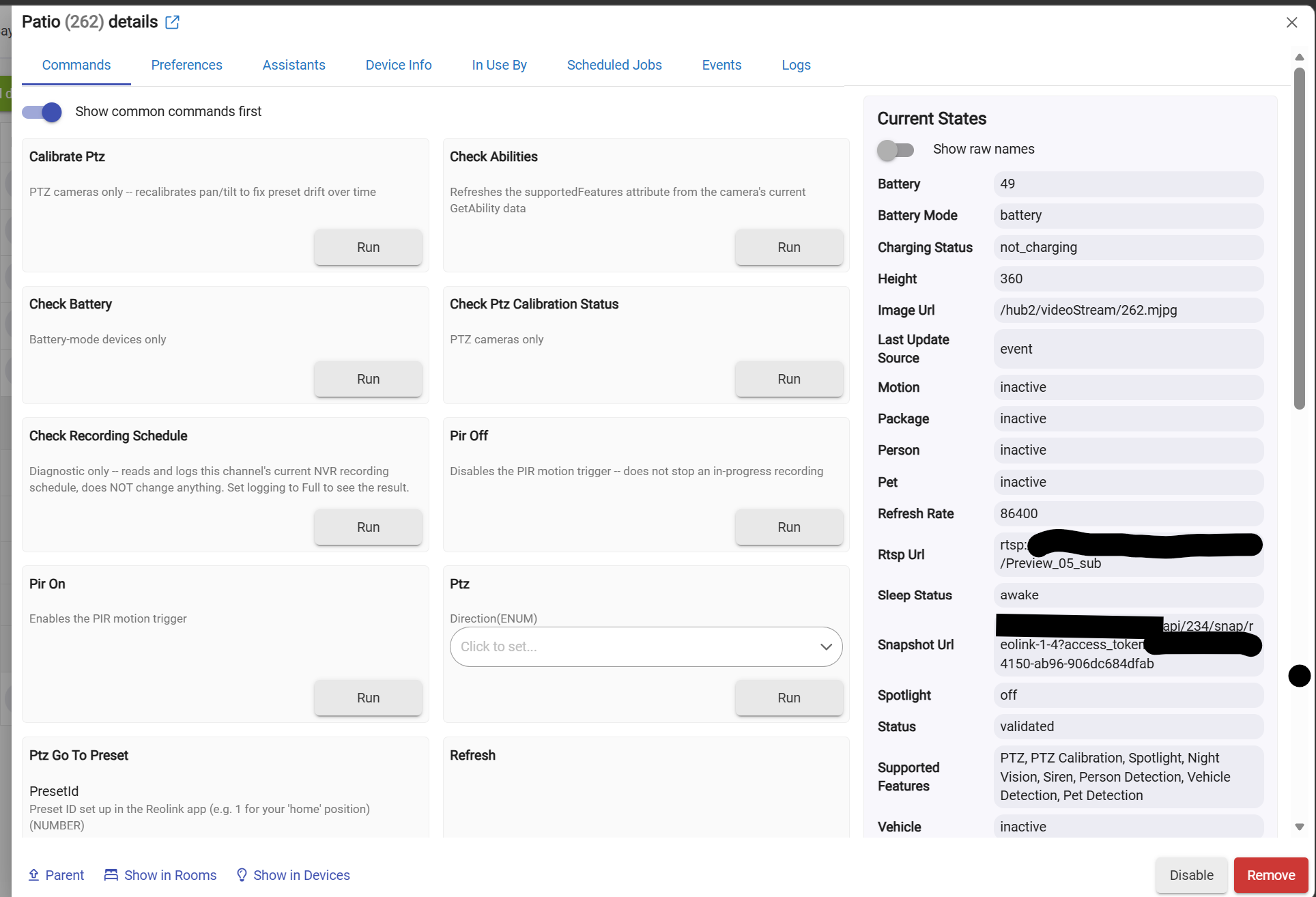

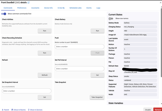

Thanks for the quick reply.
I captured a Full debug window of about 5 minutes (09:55:24 to 10:00:05 hub time), then set the log level back to Errors Only. Your suspicion looks right: the standalone sources are polling constantly even though their event subscriptions are on.
Settings
  • useEventSubscription is true for sources 1, 2, 3, 5, 6, 7, 8, 9 and 10. Only source 4 has it false.
  • Source 5 isn't created (create_5_0 = false).
  • The main page shows one source as "Polling" and the rest as "Configured" or "Online".
What the log shows
Sources 2, 3, 4, 6, 7 and 8 each run this pair roughly every 3 seconds, matching the 3s default poll interval:
  • Reolink source N: GetAiState (ch 0) succeeded -- raw: {channel=0, dog_cat={alarm_state=0, support=1}, face=..., people=..., vehicle=...}
  • Reolink source N: GetMdState (ch 0) succeeded -- raw: {state=0}
  • Reolink source N ch 0: response received (still awake)
Each call is preceded by reusing cached token, expires in ~3300s, so it's not a token or login loop.
Source 9 also ran GetAiState/GetMdState at 09:59:45-46, right as its event subscription came back (event subscription ACTIVE, event connection connected).
The window had about 2,061 debug lines, roughly 7 per second, with 7 or more sources polling at once. At ~486 ms average per run, that matches the excessive-load throttling.
Other things in the log
  • Device Bridge (source 9) receives pushes it doesn't handle: cmd_id 78, 79 and 291. Device Bridge (source 10) receives cmd_id 93. The body is logged only as <?xml version="1.0" encoding="UTF-8" ?>, so the payload is cut off.
  • Source 10 logs keepalive sent, connection healthy. Source 9 previously logged no real traffic received in 90s... forcing a reconnect every 4-6 minutes, which I saw before this window.
Your questions
  1. Source 9, see my next response. Not sure how to relate what source is which camera. . Before this window the reconnect loop showed only on source 9 in the logs I read. Bridge devices for Lower Garage and Basement Door were also very busy in the stats.
  2. Poll interval workaround: not applied yet. I can raise each camera's poll interval from 3s to 30s next and report Performance stats after an hour.
  3. Full debug logs: the excerpt above is from that window. I can paste more raw lines if you need them.
It looks like the poll timer keeps running when event subscription is active. Is there a setting to turn polling off for event-subscribed cameras, or should the app skip the poll while the event connection is healthy?

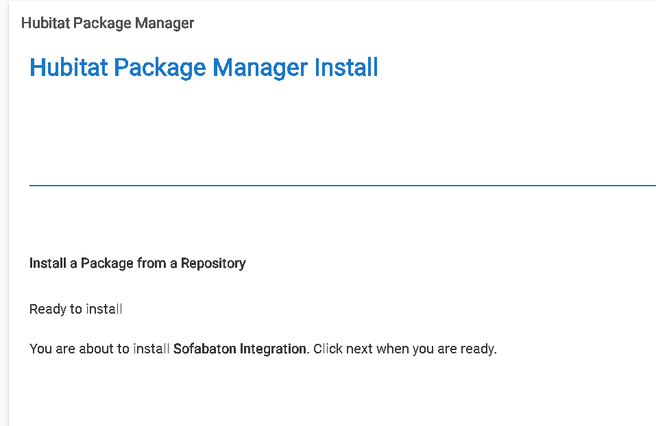

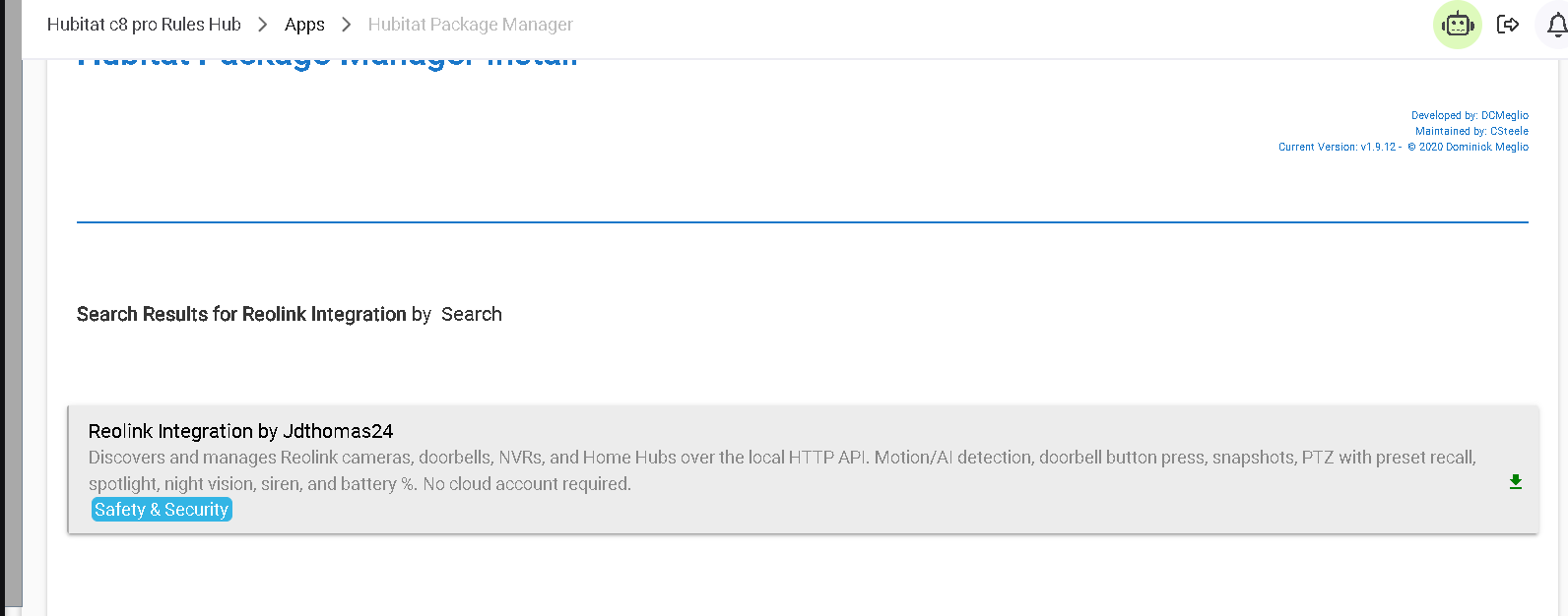

When i click on install i get Sofabaton?:
You literally caught that while i was fixing it...... :frowning:
This is fixed in GH.
Apologies, (PEBKAC) wrong credentials .... working now

Thanks for the quick reply and for clarifying that Set Night Vision controls IR on/off. Greatly appreciate you agreeing to add the last motion date/time in a future release. With regard to Notifications on/off, I understand your rationale and can work with that. The reason I had it in my driver is to keep the Reolink App and Website in sync with Hubitat so notification settings can be controlled in multiple places.
As for Battery, I ran the check battery command again on all 5 devices, and they are all still showing as battery devices instead of wired (POE). Here is a snapshot of one of the camera's, the doorbell, and the log.
Here is the log for one of the devices:
**app:234**2026-09-29 9:07:50.731 pm
debug
Reolink source 1: GetBatteryInfo (ch 4) succeeded -- raw: {Battery={adapterStatus=0, batteryPercent=49, batteryVersion=40, chargeStatus=0, current=0, lowPowerFlag=56, temperature=0, voltage=0}}
**app:234**2026-09-29 9:07:50.673 pm
debug
Reolink source 1: reusing cached token, expires in 3412.45s
**app:234**2026-09-29 9:07:49.476 pm
debug
Reolink Device Bridge (source 1): keepalive acknowledged (cmd_id 93)
**app:234**2026-09-29 9:07:49.372 pm
debug
Reolink Device Bridge (source 1): keepalive sent, connection healthy
**app:234**2026-09-29 9:07:39.476 pm
debug
Reolink source 1 ch 4: capabilities rechecked -- PTZ, PTZ Calibration, Spotlight, Night Vision, Siren, Person Detection, Vehicle Detection, Pet Detection
**app:234**2026-09-29 9:07:39.470 pm
debug
Reolink source 1: GetAbility (ch null) succeeded -- raw: {Ability={3g={permit=0, ver=0}, abilityChn=[{aiTrack={permit=6, ver=1}, aiTrackDogCat={permit=6, ver=1}, alarmAudio={permit=0, ver=1}, alarmIoIn={permit=0, ver=0}, alarmIoOut={permit=0, ver=0}, alarmMd={permit=6, ver=1}, alarmRf={permit=0, ver=0}, batAnalysis={permit=0, ver=0}, battery={permit=0, ve
**app:234**2026-09-29 9:07:39.159 pm
debug
Reolink source 1: reusing cached token, expires in 3423.965s
**app:234**2026-09-29 9:22:50.201 pm
debug
**app:234**2026-09-29 9:22:50.081 pm
debug
**app:234**2026-09-29 9:22:43.444 pm
debug
Reolink source 1: GetBatteryInfo (ch 2) succeeded -- raw: {Battery={adapterStatus=49, batteryPercent=0, batteryVersion=12841144, chargeStatus=0, current=0, lowPowerFlag=12836472, temperature=0, voltage=0}}
**app:234**2026-09-29 9:22:43.260 pm
debug
Reolink source 1: reusing cached token, expires in 2519.864s
Your camera settings look right. HTTPS on 443 is exactly what's needed. "No response" means Hubitat couldn't reach the camera at all (a wrong password would show a different error), so let's check the network side:
  1. Ping from Hubitat: Settings → Network Test → ping the camera's IP. Does it respond?
  2. Browser check: from a computer on the same network, open https://[camera IP]. Do you get the Reolink login page? (A certificate warning is normal.)
  3. Same network? Is the camera on the same subnet or VLAN as your Hubitat hub? If your cameras are on a separate VLAN, Hubitat needs to be allowed to reach them on port 443, and port 9000 for real-time events.
  4. Connection settings: in the app, under Edit connection settings, confirm the IP matches the camera's current IP and the HTTPS port is 443.
If the ping fails, try Find changed IP in the app. If everything checks out and it still fails, set the log level to Full, run Re-run discovery, and send me the logs on DM.

Thanks for the logs, they pinpointed the issue.
Your cameras are behind an NVR, and the NVR answers the battery query even for PoE channels, but with junk data (for example, zero voltage and nonsense version numbers). The integration was treating any answer as "battery camera." Your camera's own ability report correctly says it has no battery, so I'll switch detection to use that instead. That fix will be in the next release (1.6.5), and it will also clear the incorrect battery values from your PoE devices automatically.
On notifications: thanks for explaining. Keeping the Reolink app and Hubitat in sync makes sense for your setup. For now I'm keeping notifications on the Hubitat rules side, but I'll keep your use case in mind.
1.6.5 will be released today.
