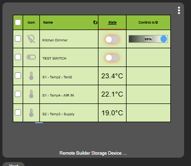

Now when i was playing around with sizing to try to get the table as small as possible to fit on a phone screen i noticed what seems to be an extra column:
Can you comment on this? If i delete the "colgroup" the table fills the tile area nicely:
EDIT: I figured out this happens only when you remove the first column (Hide Column 1 - Selection Boxes?)

Thanks for sharing that. Should be easy to fix now you reproduced it. Thank you.
Trying to recall why I had to add a colgroup in the first place. I think the need for that has been eliminated when I changed the sort header highlighting. I love when I can remove lines of code and do no harm.
I’ll have a fix tomorrow.
That is an oversight on my part but it should be an easy fix. I think the text color setting should apply to all text other text other than the header. If you agree I’ll have a fix for you tomorrow. Thanks for helping to shake the bugs out of this.

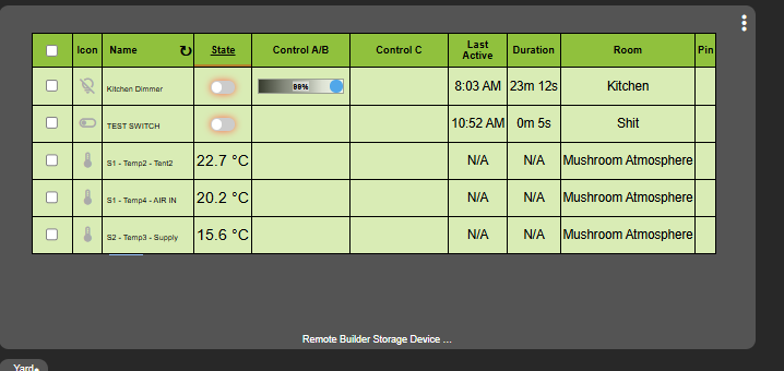

This is what I get even after the publish.... in two different instances:
And it is the current version. At least the bottom of the page says:
Version: Remote Builder - SmartGrid 3.1.5 (1/12/25)
When I go to the actual Dashboard after the publish it looks like nothing has changed. Maybe the update didn't do something it should have? Going to run the repair option in package manager and see if that fixes it.

Also I just tried to hide Column 5 and 6 but they still display in the preview and on the dashboard when published.

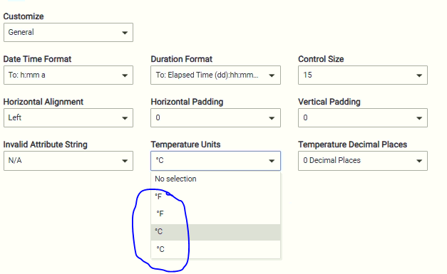

And just another FYI, I found that the temperature Unit selection is showing double:
Also it looks like the state column is ignoring Text size. My goal is to make a table small enough so that all the info/data can fit on a portrait-orientation phone screen. It looks like the state text and icons are not resizing properly. Im assuming this is because they are not strictly strings but also image or icons. This must be a challenge to get working properly. you can see in the image below i have all text set to 50, but the rows are kept higher because of the state column:

So its only the size of the text in the state column that is not resizing together with the row text.
EDIT2: Row text size is only being applied to the name column. I hope knowing this will make it easier for you to find the issue here ![]()
