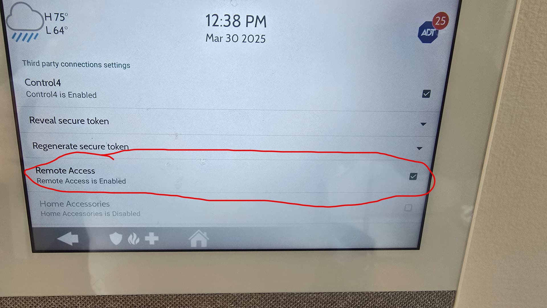

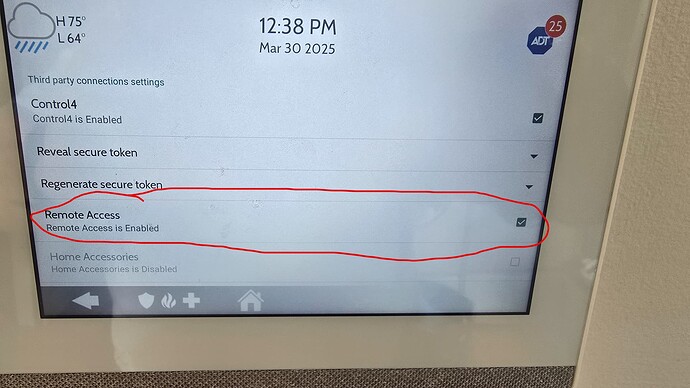

Hey all! Thanks to @dcaton1220 for these drivers and for everyone else who has posted info in this thread. I'm a newbie hubitat user and just got my QOLSYS IQpanel4 from ADT connected to Hubitat. It took me quite a bit of doing through brute force guessing the dealer code (lol me, I have no life) and browsing through the responses in this forum while debugging things.
I was about to make a post showing my setup and asking for help but decided to give it one more try. I discovered a setting in the 3rd Party Wifi connections screen Dealer Settings of the panel that I hadn't noticed before and that I don't see mentioned here or in the instructions. There is a Remote Access checkbox that must be enabled or the connection will fail. It's a separate setting from the Control4 enablement setting.
This panel removes the Control4 settings if no devices connect within 15 minutes, and it timed out on me several times yesterday while I was trying to get things set up. It's entirely possible that this checkbox gets enabled automatically when Control4 is enabled, But if it is not checked then the connection won't work. I checked it and now it all works!
