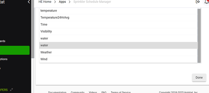

My questions is I am seeing 2 water attributes. Is this correct or do I have a faulty install? If it is correct, which do I choose for wet/dry?
Two water attributes is an item I asked Gary to look into a few weeks back but he's been away for a bit. He told me he'd look at it when he got back.
I believe it's just cosmetic, either water attribute will work.
Thanks!

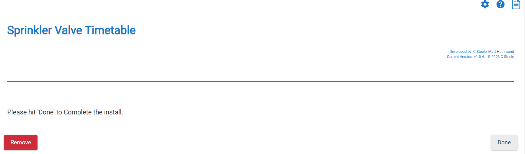

Just installing your App now.
I found this a little confusing.
I expected to see an interface where I could configure things.
I'm sure there is a good reason but a little extra info on that page would not go amiss.
Sorry, this was supposed to be a DM.
you gotta do what it says first :smiley: :smiley:
click the DONE button
lengthy answer:
Child apps don't get saved til the Done button is clicked. So without this step, if you got into the child and started setting up a lot of timelines, etc. and clicked Back or closed the browser tab, it would be lost and I'd get that flood of messages :smiley: This method, which I first saw used in HubConnect back in 2019, means the child is at least created and saved, empty but ready to be configured.
Here is the deal:

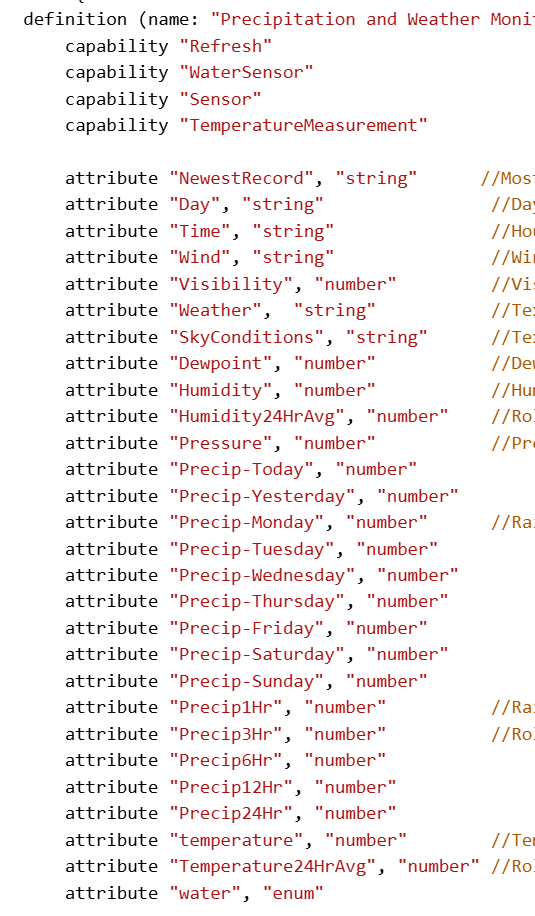

You are getting a water variable for the capability "WaterSensor" and another one for the attribute "water".
I don't know about you but I have always declared both in my drivers and my guess is that others have as well. I wonder if there is a difference in the API in one of the recent updates.
chatGPT says you could de-dupe with this change to your code (not tested).
atts = outdoorRainDevice?.supportedAttributes
.collect { it?.toString()?.toLowerCase() } // Normalize case
.toSet() // Remove duplicates
.sort() // Sort in natural order
Probably best to assume other drivers will have this issue and add this workaround to your code.
I understand the WHY -- you have the same attribute defined twice. Groovy allows overloading but in this case, no overloading is done.
It looks like a flaw to my eyes for the case of someone else maintaining the code, I wouldn't do it intentionally. I've done a bunch of "the guy that maintained this is gone now, you should take this 7 year old code" this year and I'm not enjoying the gotchas that are not my own. :smiley:
I'll add the workaround because ChatGPT has led me astray only 38% of the time, so far. We're running neck and neck, although I do feel like I might eventually fall behind. :smiley:
I will remove the attributes, I'm just saying that I don't think I'm the only one guilty of doing this. Later on I remembered de-duping the attribute list in Tile Builder but not really digging into the WHY at that point.

Code updated to 1.1.2 to eliminate appearance of duplicate water and temperature attributes (harmless but annoying).
