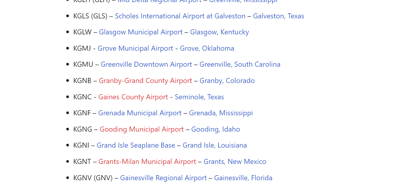

I just installed the app/driver via HPM. It looked like everything installed correctly and I was able to create the virtual device but I can't get it to pull data. I'm using ICAO code KGME. I checked the log and I keep getting the following error on refresh:
groovyx.net.http.HttpResponseException: status code: 404, reason phrase: Not Found on line 338 (method refresh)
refresh(): A data refresh has been initiated.
Has anyone had this issue? Or know what I'm doing wrong?
404 means "Not found" -- that the URL it's trying to fetch is not finding a page. It probably means you entered the Airport Code incorrectly. "K" + your desired Airport.
Yep, no airport with code KGME
Use the link to the Wikipedia page on the OP for a list of valid codes.
That was it. I was supposed to use KMGE. Tpyed it correctly and it is working now. Thanks for the help.
