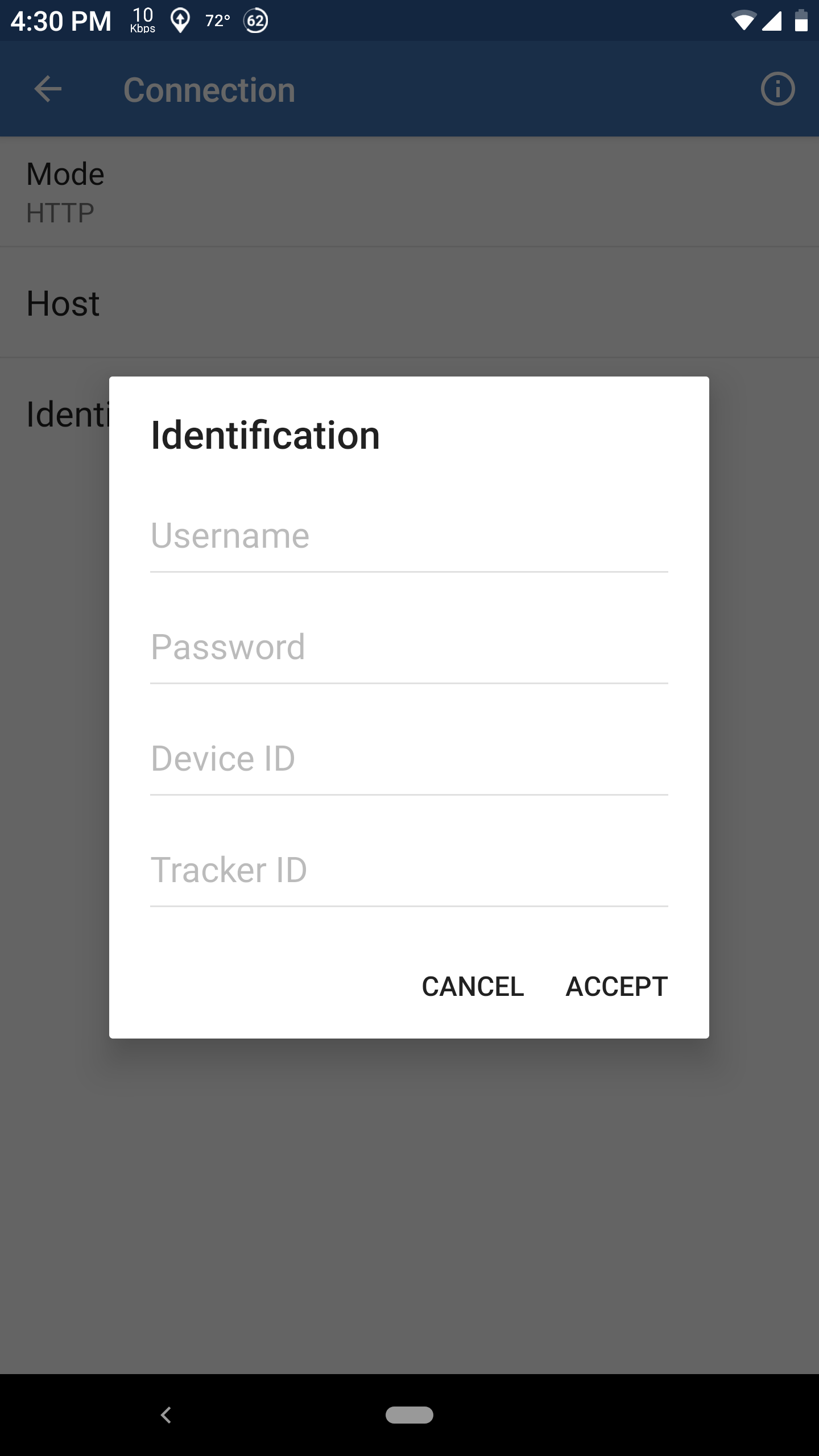

So I am trying to set it up on my Android device and that UserID field does not seem to exist, see screenshot below. Any ideas?

It looks like @brianwilson has removed the [person] step from the setup process with the latest update. I am not sure what other advise I can give but maybe to update the Hubitat app and start from scratch. When you get everything up and running make sure that you disable battery optimization for the app on Android as well as changing location access to always.
You don't need to put anything into the identification part of the app if you are using HTTP. I am using the significant changes mode.
Okay, then where is this UserID field that I have to fill in? The Android app seems to be completely different from the iOS app btw based on the screenshots above. Even when I try to manually add a "UserID" in the configuration management, it says invalid key for that term.

Where is the UserID field in the android app?
My bad, it says Username, not UserID. I scanned over it quickly and saw that and Device Id.
So I added everything before the latest update that changed some things but to those having issues with the username in the Android app try this. Take the name from the virtual device such as Home-Name and put it in the long url that you put into the app as the Host. You should put the name after the location in the url so it should look something like @@@@@/location/Name?access@@@@@@. Also make sure that you are using the virtual device driver called Virtual Mobile Presence for OwnTracks.

You can still do this step and things will work, but if UserID is set OwnTracks (username on Android?), you don’t need /location/[user] in the URL.
