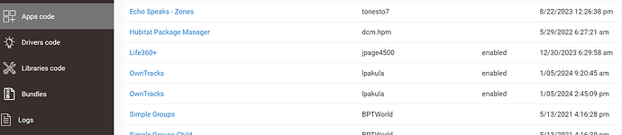

I must be thick. I have this:
in the Apps code area.
If I open the Apps I get this:
Not sure how to confirm if the new version is running.

To be absolutely sure, look at the line in the Apps Code that I showed you.
Take a look in your apps code app list to ensure you don't have the Owntracks app showing up twice. Oh wait, you do have it twice. Likely the first is the older version and the second is the newest...but check their version numbers in the code.
I tried to delete the old one, but it won't and is stating it is still in use. How do I change to the new one and delete the old one?

Copy/paste the app code from the 1.6.1 version into the older version, and then save the changes.
Then delete the second unused app instance in Apps Code.
Then go back into HPM and run a match-up - it should then match up to your one instance of the app.
Then you can go back into the app on your Apps page and configure as desired. The newer version should help w/your errors...

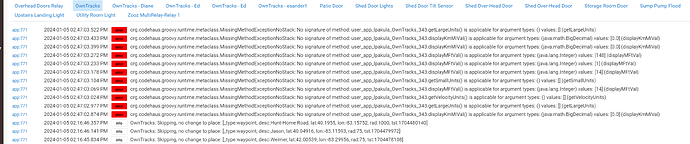

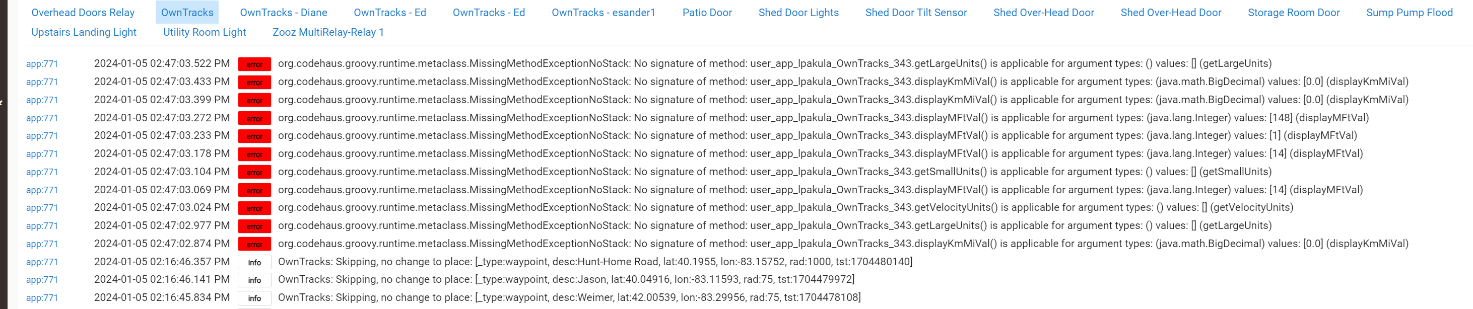

Version 1.6.1 will fix that. There was an issue on the cast when it's trying to convert metric to imperial.
Are you on version 1.6.1?

Hmmmm.... odd. Nothing was changed that should impact the presence, except if you were getting the errors in the log (like from 1.6.0). Those errors occured as the location was pushed to the driver, and then the driver would have aborted, hence no presence.

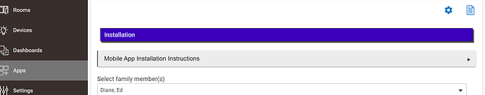

Took me a while only because i couldnt locate the Manual Update to the mobile app android
Somehow it finally worked and updated to where i can do the final changes
