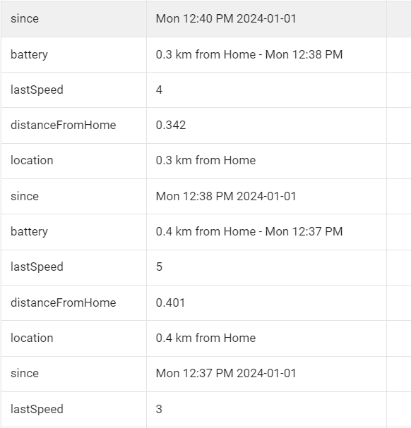

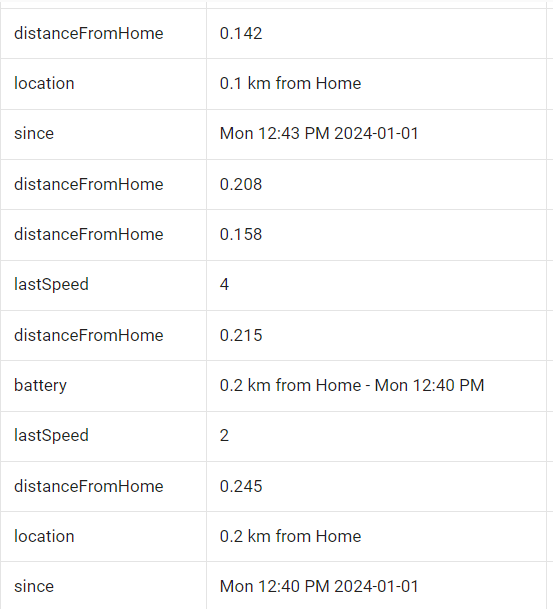

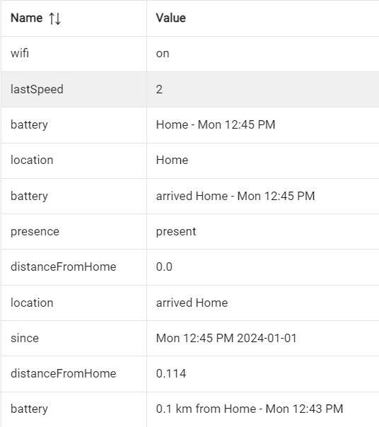

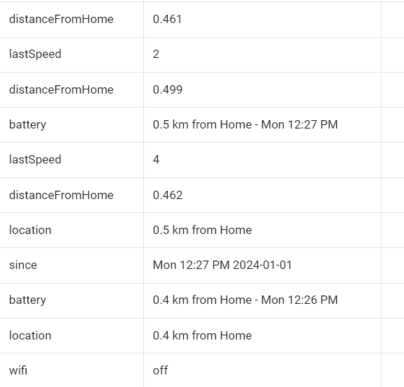

@lpakula - finally had a chance to test the new setup taking the dogs for a walk, and it seemed to work perfectly for me. Caught my departure very quickly as well as return. The accuracy seems excellent. Looking forward to using this more. Thanks for all your work on this.
From device Events tab:
2024-01-01 13_30_44-Hubs, Network, & Tech
Why is the battery value not a battery value?
That's just how @lpakula set it up...you can choose what you want to display in the current states for the Battery attribute:
I guess I could have selected "Battery" as default. On the "presence" tiles for the dashboards, the top row is "Battery" and it happens to be a string. I reused it for more "useful" (IMO) things like location and since time:
It is a per-device setting.
Yes, I like your choice very much. I do not need HE to use a presence device tell me the battery level on my phone. :slight_smile:
