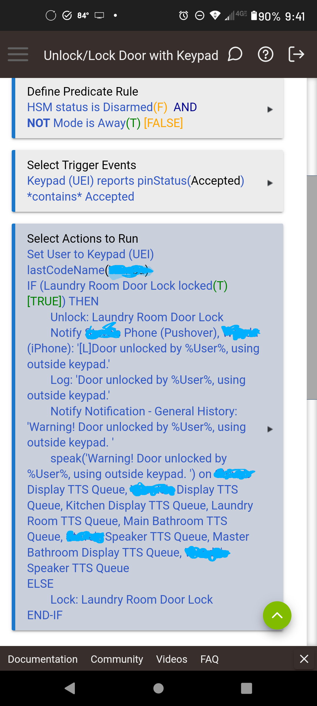

Everything is done and now the waiting starts. Here is my rule. If a good pin is entered the lock will lock if unlocked or unlock if locked. The UEI keypad will accept pins without pressing one if the arming buttons.

Update: After looking at @oldcomputerwiz's rule, with my system disarmed, using an Xfinity branded Centralite 3400 keypad, after entering a valid pin without an amring code, the lastCodeName attribute changed to the name associated the pin. When a bad pin was entered pinStatus was set to rejected, and the codeEntered attribute contained the bad pin. codeEntered does not display when a valid pin is entered. This will likely not work using an Iris keypad due to the hardware not sending the pin code without an arming code.
