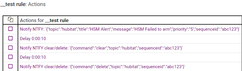

Putting that all together, with this hypothetical rule:

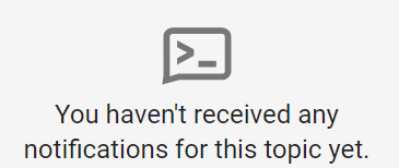

then 10 second later I have this:
