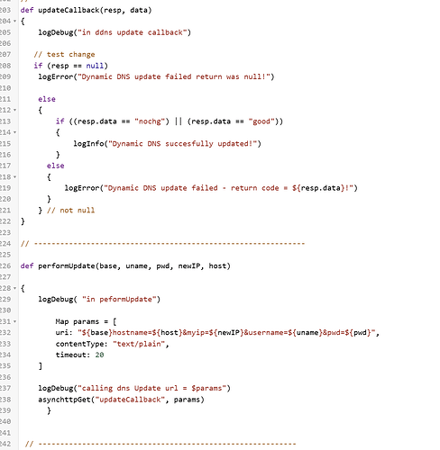

first version of my dynamic dns updater script.. works for dynu dns..
but the base url is encoded in the parameters so it most likely will work for others similiarly and if not one fx will need to be changed.
https://raw.githubusercontent.com/lgkahn/hubitat/refs/heads/master/DDNDS%20Update
these are the two functions that may have to change depending on your dynamic dns provider

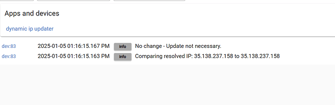

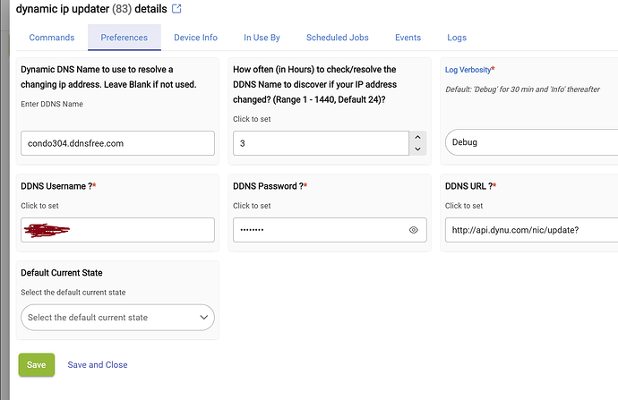

v 2 avail. some new attributes to track update last and future times and cleanup of the code and logging..
v 2.1 add last result attribute to be used as status display on device list. or in dashboards
