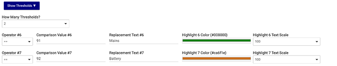

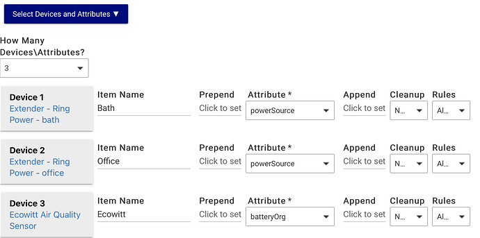

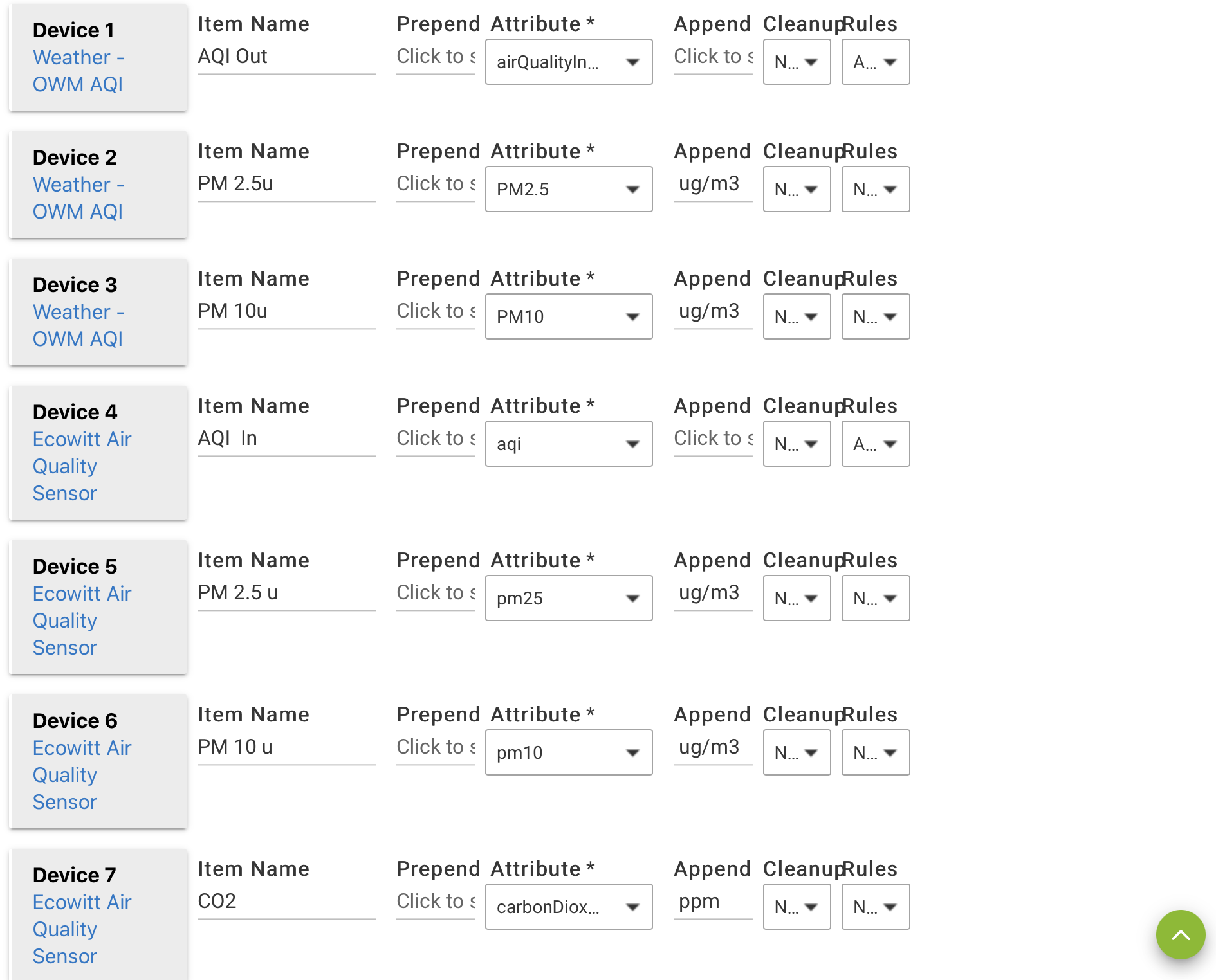

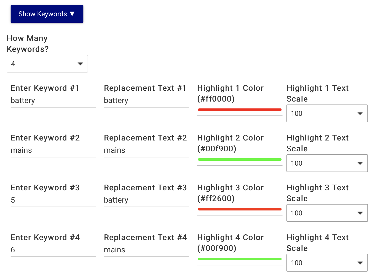

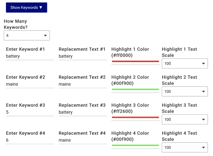

I've found another one. I have a tile that is used to show devices that have switched from mains power to battery. I had two ring power extenders that have been working on this tile, and I wanted to add an Ecowittl Air Quality Sensor. The Ecowitt has a batteryOrg value of 6 for mains and 5 for battery. I added keywords to change this. The keywords are not working. Here's the setup:
And here's the result:
And I'm getting the same error on the first two, but nothing on the third:
I've not dug into the logic of the code yet but try this first. If a value converts to an Integer or float I'd recommend using Highlights rather than Keywords.
So the two keyword rules would stay the same and keep a Rules setting of all Keywords as you have already. You would remove the 5 and 6 as keywords.
Add two highlights like this and use 5 and 6 for the two rules.
That should work.
I figured it out. It's basically a logic error in the code. For now, if you turn on "Also Highlight Device Names" that will take the correct branch and you won't see that error.

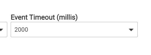

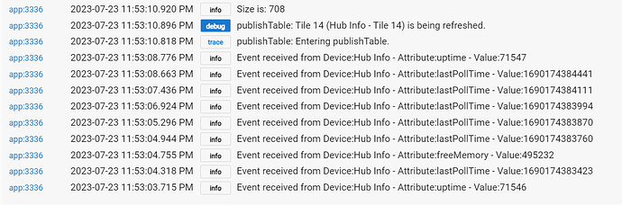

Because MAM can have multiple subscriptions to multiple events on the same device it can receive a lot of updates within a very short period of time. For example here is the log from updating the Hub Info device with the event timeout period set at 0 (the prior default).
8 updates received resulted in 8 publishing events.
Setting the Event Timeout to 2000 ms and the event log looks like this.
This has not been an issue with Attribute Monitor where we are only monitoring one attribute per device so a dump of consecutive changes is a less likely effect. That said I will add it into Attribute Monitor on it's next update but the Event Timeout default will likely be 0 (as it currently is).

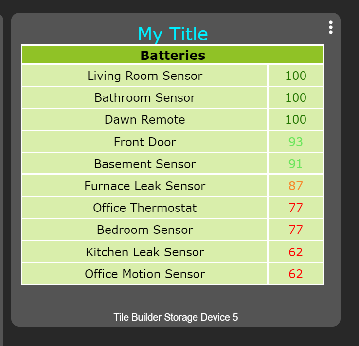

I'm having trouble displaying a tile when I add more than 2 thresholds for comparing battery levels. I am building a tile to display battery levels for 10 devices. I'd like the colors to be Green for 100%, light green below 99% , orange below 70%, and red below 50%. The tile displays correctly on the local dashboard, but will not display on the cloud dashboard. When the cloud dashboard is used, the tile data is blank. If I use only 2 thresholds, the tile will display correctly on both the local and cloud dashboard. If I set 3 or more thresholds, the tile is blank on the cloud dash, but visible local dash.
edit: Additionally, very repeatable, if I add a Title to the tile, the tile displays blank on the cloud dashboard.
Here is what I created:
My ranges are different but they work as expected. The important thing to note is that each threshold you add has higher priority then the prior ones.
Notice my tile is 1056 bytes so this is sent to a file on the hub and is displayed on the Dash via an iFrame. In this exampled I used a merged header vs a Title to save space.
If I add a Title it shows like this.
With 10 batteries my guess is your tile is being saved to your File Manager. Have a look there and see if you can find it.

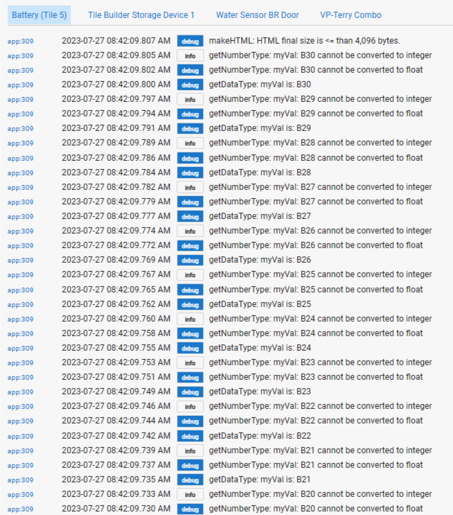

The tile shows correctly in the File Manager. It also shows correctly when using the local web or hubitat app, with all the correct thresholds and colors. However, when the cloud dashboard is used, the tile is not visible if I add more than 1 threshold. Also, I built a similar battery tile with only 2 thresholds, and it works both locally and on the cloud dashboards. But when I add a Header to the working tile, it will not display on the cloud dashboards. very repeatable, I can drop the thresholds to 1 and it will display, and add a few thresholds and it won't display on the cloud dashboard.
In the image below, 2 similar tiles for batteries. the tile on the left has 2 thresholds (<60 and < 40) and the tile on the right that is blank has an added threshold and not displaying.
The logs show a lot of these entries
getNumberType: myVal: B28 cannot be converted to integer
myVal: B28 cannot be converted to float
What you are running into is the 1,024 byte limit for Dashboards to directly display info.
When you generate a Tile the code looks at the size. If it's under 1,024 then it is stored in the HE database and will be visible from the app anywhere.
When you generate a tile > 1,024 bytes it is stored on the File System of the hub. This is available locally but it's not available via the web. Instead you get a space where the tile would be.
So, if you want to see your tiles via the web you must keep them under 1,024 bytes. The next rev of Attribute Monitor will adopt some of the optimizations from Multi-Attribute Monitor and give you an extra 100-200 bytes per tile in most cases which should help.
Notice when you are creating a tile it shows the size and what features are turned on. This is all to assist you in keeping it under 1,024.
You have the Advanced version so consider this. Your tile shows 10 battery devices. Do you really need to see those that are at 100%?
You have options.
Both of these strategies will keep the size under 1,024.
With a limited result set you can also use a graphical option to display battery levels if you so desire.
Note the minimal formatting to save space.
You can find instructions on how to do this in the help manual which is linked in the app and the original thread.
I'll reduce the number of log messages in the next version, but they don't indicate a problem.
