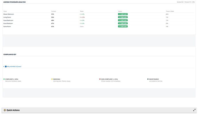

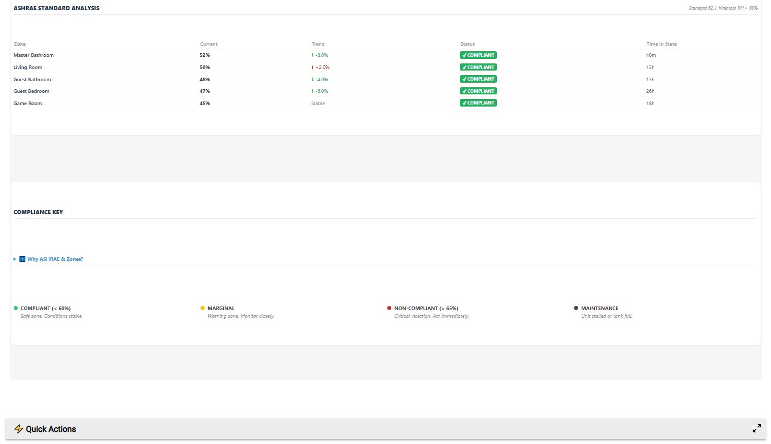

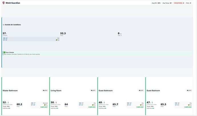

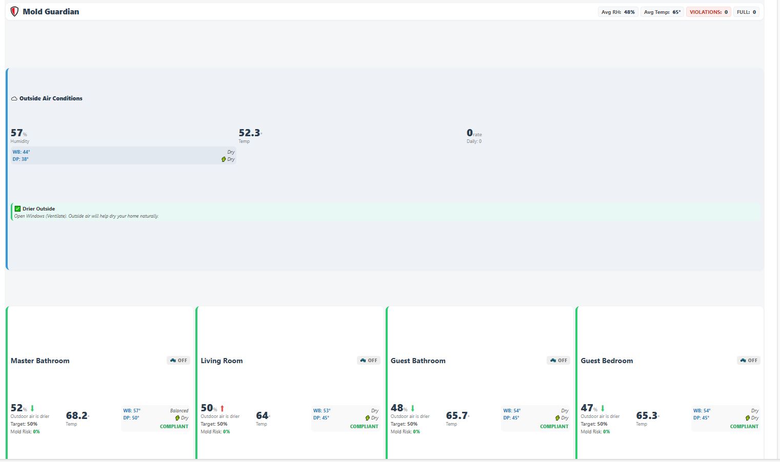

5. :bar_chart: The Dashboard Tile
The app generates a beautiful, rich-text HTML tile for your Hubitat Dashboard that displays:
  • Zone Name & Status Badge (Running, Off, Tank Full, Offline).
  • Current RH% & Temp with Trend Arrows (:arrow_up:/:arrow_down:).
  • Derived Science: Displays Dew Point and Wet Bulb temperature.
  • Mold Risk Score: A color-coded percentage (0-100%) showing cumulative risk.
  • Advice: Tells you to "Monitor," "Ventilate," or "Empty Tank."

The ASHRAE Compliance Check
On top of the prediction index, the app performs a strict standard check:
  • Safe (Green): <= Target Limit
  • Marginal (Yellow): < Target + 5%
  • Violation (Red): >= Target + 5%
