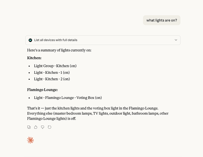

Once set up, you can control your smart home with natural language:
  • "Turn on the living room lights"
  • "Set the thermostat to 72 degrees"
  • "Lock all the doors and set the house to Away mode"
  • "What devices are currently on?"
  • "Dim the bedroom lights to 30%"
The AI figures out which Maker API endpoints to call based on what you ask. It's pretty slick.

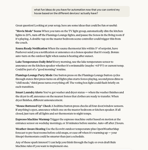

I put together a guide and an OpenAPI spec that covers the full Maker API:
GitHub: GitHub - craigde/hubitat-mcp-server: Workato MCP Server for Hubitat Maker API · GitHub
The key is using Workato's free Developer Sandbox to host the MCP server. This means:
  • No server to run or maintain
  • No tunneling or exposing your local network
  • No cost (100k free events in the sandbox)
  • Works with Claude, ChatGPT, Cursor, and other MCP clients
Requirements
  • Maker API with cloud access enabled (Workato needs to reach your hub via the cloud endpoint)
  • Free Workato account (workato.com/sandbox)
  • Claude and/or ChatGPT account
The README has full step-by-step instructions for setting everything up: creating the Workato project, HTTP connection, API proxy, MCP server, and connecting it to your AI assistant of choice.
Why This Approach?
I wanted something I could set up quickly without running infrastructure. Workato handles all the MCP protocol details and gives you a secure hosted endpoint. The free tier is generous enough for personal/experimental use.
If anyone gives this a try, let me know how it goes. Happy to help troubleshoot. And if you find issues with the setup or want to improve the docs, PRs are welcome.

Without MCP, if you ask Claude "what lights are on?" it can only guess or say it doesn't know. With MCP connected to your Hubitat, it can actually call the Maker API, get the real device states, and give you an accurate answer. Same for commands: "turn off the kitchen lights" triggers a real API call to your hub.
How input works:
Right now it's text-based through whatever interface you normally use to chat with Claude or ChatGPT. So you'd type "what lights are on?" in Claude's web interface or the app, and it responds with actual data from your hub (like in my screenshot).
Voice could work if you're using a voice-enabled interface to the AI. Claude's mobile app has voice input, for example. You could also build something with the Claude or OpenAI APIs that takes voice input, converts to text, sends to the AI with MCP tools available, and speaks the response back.

This is neat! I have been tinkering with OpenClaw this weekend and it was able to generate an integration plugin for the maker API on the first try! Some of this stuff is amazing…
Yea I've used it in a bunch of different tools now - openclaw is next to play with.
I had a bad time getting OpenClaw set up. The documentation is incomplete to be generous, and the web portal is really very clearly optimized for someone with a 486" widescreen monitor. I gave up on several separate messaging channels before finally just going with slack so I could get it up and running.
But here's the best part and why I mention it. After I got it running by following the docs, I asked it to audit it's own config and slack bot install and it found a list of a dozen places that weren't in the docs that needed to be changed :laughing:
It then was able to correct or direct me to fix the rest of the install, and guided me through getting BlueBubble setup, and a bunch of other stuff too. I've been impressed with it in general.
