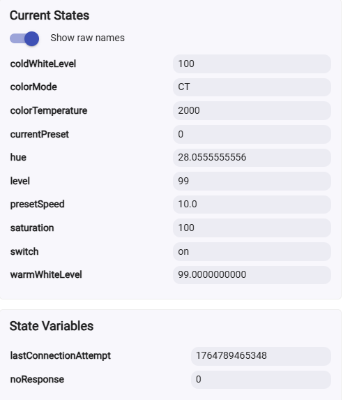

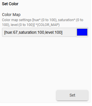

So I have been using these for some time, bue I am nto sure when, but at some point something changes (I have not chnaged the driver code or my rules). But I am running the "MagicHome Wifi - Controller (RGB + WW/CW CCT) 0.89" version. And when I set hue through the driver it works as expected.
However when I go to chnage the level, or saturation it changes it to warm white and adjust those levels. It nolonger allows me to adjust the brightness level or saturation level for colors like before.
Also I notice that the Driver is in CT mode and I do not see a way to change it in the driver settings. And belive this is where the issue is comming from.

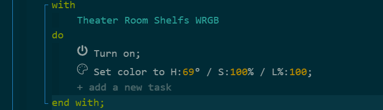

how can I get it back working? I use webcore and even when setting hue/saturation/level it also reverts to warm white.
