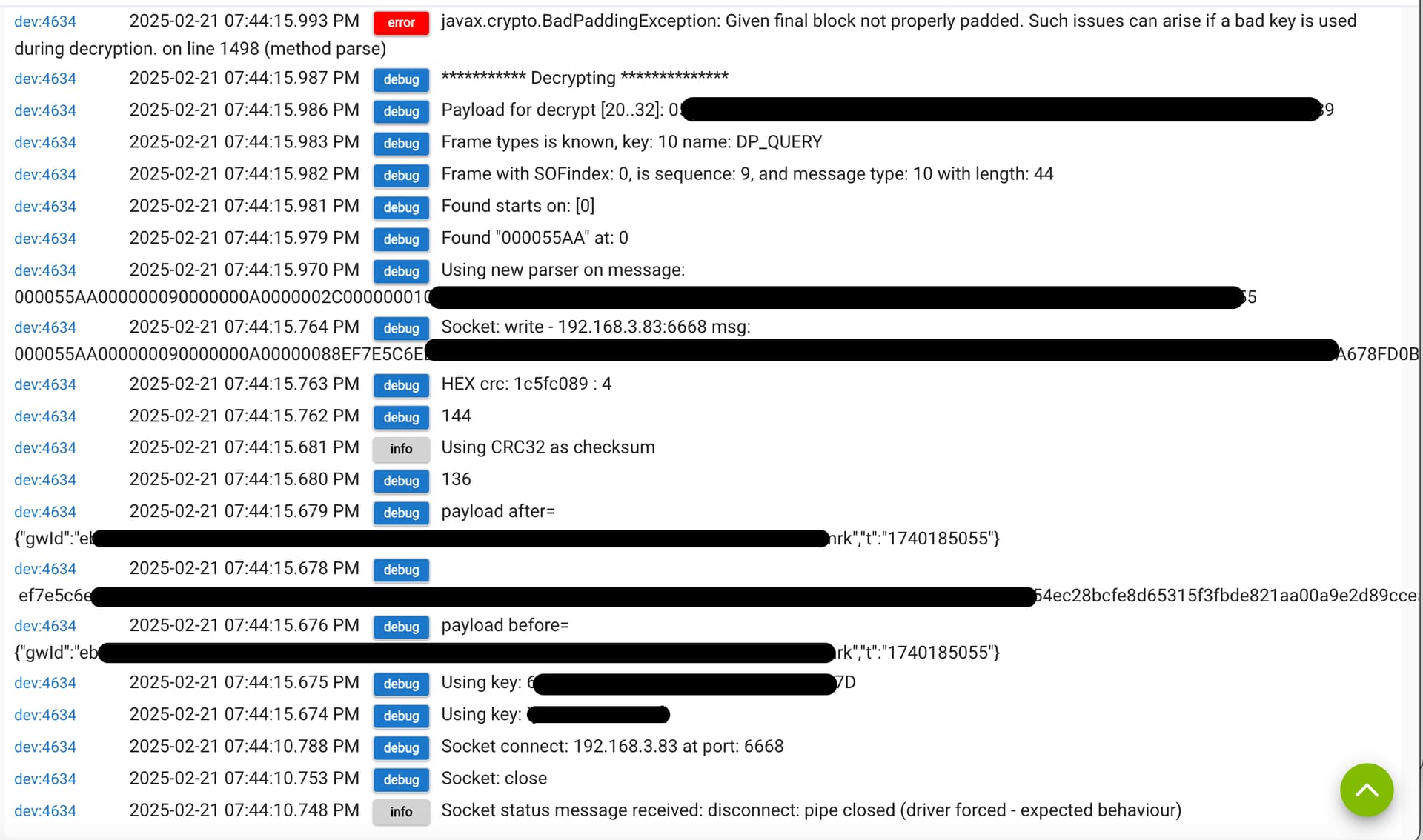

Now I am at this local key error:
dev:5752025-01-29 14:46:14.730
error
javax.crypto.IllegalBlockSizeException: Input length must be multiple of 16 when decrypting with padded cipher on line 1498 (method DriverSelfTest)
I got the local key from tuya developer
HI HypeTaxx,
You have to make sure your key consists of exactly 16 characters. There has been some issues in the past where the key contained special characters that was eaten by the Hubitat interface. Do not post your key here, but do you see any obvious special characters? Previously "<" and ">" has been problematic, but these was fixed.
Ideally if you can just create a similar key that generates the same error and send to me by PM it would make it much easier for me to debug and fix.

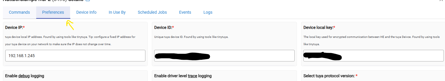

Can someone help where to enter the local key? I am not seeing an input box for it. Pls advise
Locate the device under Devices in Hubitat and select the Preferences tab, then you should see this view, which should provide fields for Device IP, ID, and local key.
Thanks for the quick reply, i found the issue. I was using different driver 'Tuya Local RGBW Light'

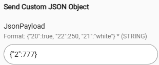

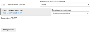

Hi all, if I send Jason it work.
I tried creating a RM but without success. Any help would be appreciated.
