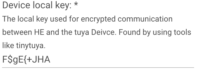

I just setup and tried to use this driver, pulled the keys, but the driver won't accept it. IE I paste in FO4:l6$gE{+JHA, and it changes it to F$gE{+JHA in the device local key field, and then when I try to hit an endpoint, I get this:
[dev:4113](https://10.54.25.35/logs?tab=past&deviceId=4113#)2024-03-21 11:23:55.551 AM[error](https://10.54.25.35/logs?tab=past&deviceId=4113#)java.security.InvalidKeyException: Invalid AES key length: 9 bytes on line 1064 (method off)
And will I need a seperate driver for each type of device I have? I'm very confused at this point...vs the cloud driver that sucks, but works, when Tuya's api isn't breaking...
Thank you!
I've added my 25 lights, they are in groups, so I've tried Motion and Mode Lighting, and lights in groups turn on randomly in the group, some come on, some don't, some go off, some don't.
I also tried in Room lighting, but as I've had issues with in the past, it doesn't even turn anything but a switch on reliably :joy:
hi michaelahess,
First of all I think IE is doing something strange with the data entry, looks like it is removing what it thinks is a time string "04:16" from the entry for some unknown reason. Can you try with Chrome or Edge, I do not see the same issue with this key on my end.
That being said, something is strange with the key you posted, the key must be 16 characters long exactly. What the driver does is that it interpret the text string as 16 bytes = 128 bits which is the AES key that is used to communicate with the light bulb.
You should not need several drivers to control several bulbs, however I did see some issues that I fixed the latest version back in February. Can you make sure you have the latest version and test again?
