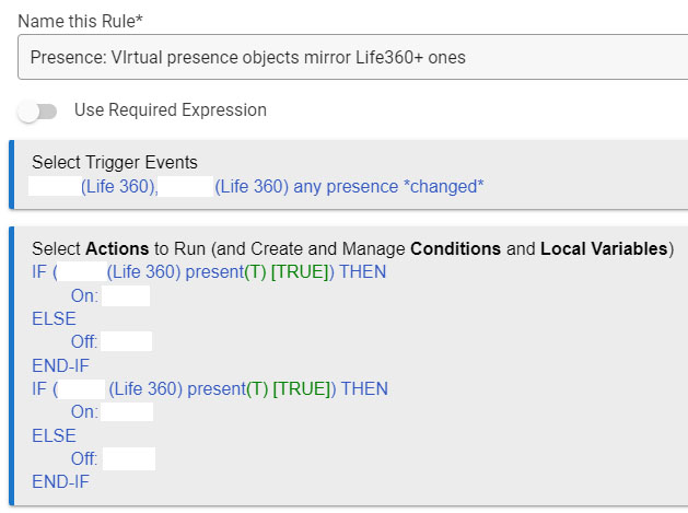

Mirror how?
That could be done with rule machine.
@jpage4500 thank you for your efforts maintaining this app. I just started using it and curious if you have considered filtering latitude and longitude events to a certain precise measurement especially if at the chosen Place, home in my case, set in the parent app. I placed my phone in its charging spot and it sat in the same spot and position all night, no movement. Looking at the device history there are frequent updates to both latitude and longitude even though the phone never moved:
There are many ways to do it. I do it with just a rule machine rule.
Note that this mirrors presence state only as that's what I use. If you use states such as isDriving, Speed, etc., this won't do that.

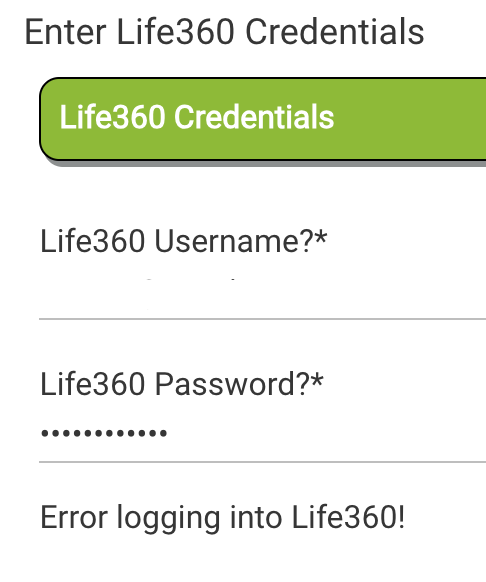

Hi Joe, I made the update in HPM, and I'm able to enter creds again without a reinstall but the app returns "Error logging into Life360!" and the logs still show "Life360+: listCircles, error: http:403, groovyx.net.http.HttpResponseException: status code: 403, reason phrase: Forbidden".

Unfortunately, I'm unable to sign in. Did they make another change? (username has been entered, it's just blanked in the screenshot.)
Existing user locations are still updating in HE. Just can't get into the HE Life360+ app.
