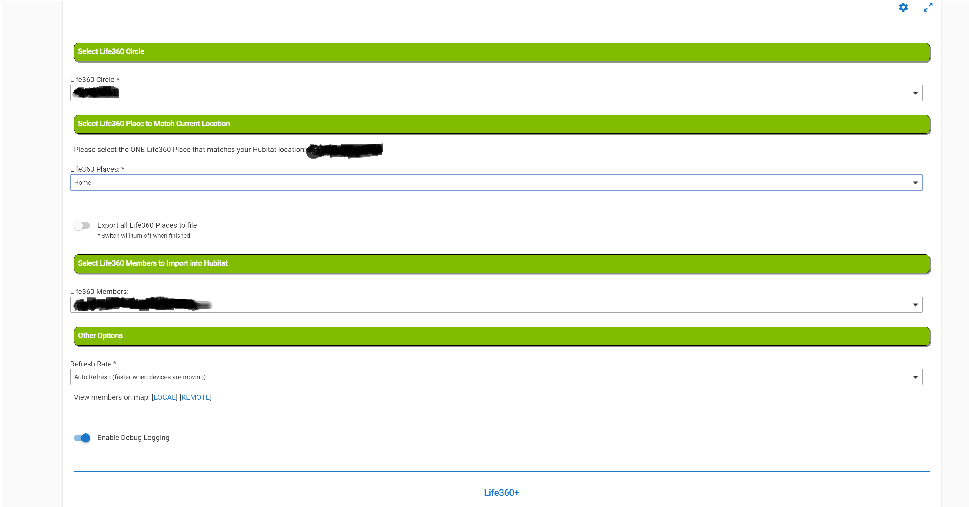

But at least we know the API is remaining open, so everyone who is currently signed in, everything should continue to work as normal. If you can't login but other tasks such as geofencing are updating then upgrade to version 3.0.24 of Life360+ via HPM and you should see the page below.
Updated via HPM, still getting the 403 error
