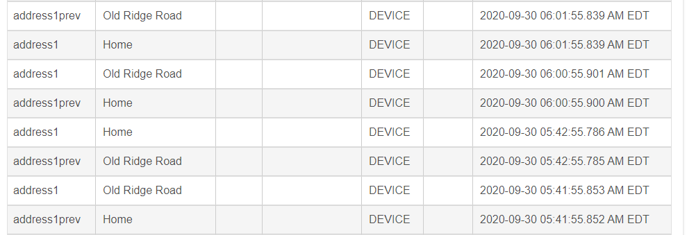

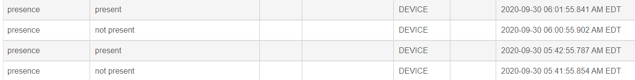

Yes, I'm glad to see I'm not alone here. Just wanted to share I was seeing issues with it as well. Hoping for a fix soon really bugs me it keeps randomly switching to away mode. Luckily I do not have my siren setup as an alarm, so I don't have to worry about alarms going off.
Just label your "home" the same as the place 360 switches you too.
Interesting concept. I'll look into it for sure. Though, I do live on a corner, so I'm concerned it would switch between the two streets. Also, for the location tracking I am using the present/not present variable, rather than the address one. I use the address one in another piston to let me know where I am (have a few vacation places added too, incase I forget to put the place in vacation mode manually). But even with the present / not present it is still randomly switching to away mode. I assume though it is tied into the issues others are seeing as well, as it was going strong for a few weeks before.
Life360 had some issues with the app last week and since it's been odd. I deleted my circles and did a search for my address and labeled it home. Went back into the app and it changed my address to a street behind my house. So I changed my home label to match the street behind my house and it's been fine since.

My proposed code workaround has been working for my particular setup. Within your Life360 device driver you determine presence by evaluating the address1 attribute equal to the value of "Home". The Life360 API has been going crazy indeed when reporting the address1 attribute, however a more reliable place geofence indicator can be derived from member.location.name via their API. Most of the time address1 will take on the place name value when inside the geofence, however occasionally the address1 value will change to a near street address value while still inside your geofence! This triggers the away and present issue everyone is complaining about.. So, my code change will override this bogus address1 value while inside the geofence, thus preserving the place name as a constant. This in turn prevents your presence from changing inside your device driver. Mine has been going strong now for several days, no issues, despite the Life360 reporting problems with address1 attribute..

If the issue is still happening, I'd suggest adding this line in the cmdHandler......
  result = resp.getJson()
  if(logEnable) log.debug "JSON Results=${result}"
That shows you exactly what Life360 is telling the Hubitat app.
If its the same issue that I was seeing, it shows up as a difference between these 2 fields.....
....., timestamp:1601542666, name:Home, placeType:null, source:l, address1:Park Road, address2:, shortAddress:, inTransit:0,.......
