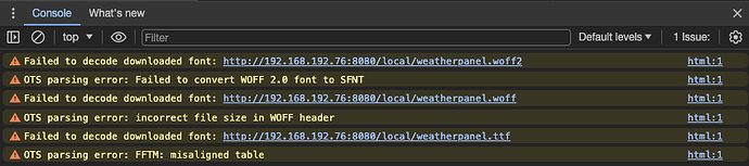

I think I found a bug in HPM, This is the package manifest I'm using and everything but the ttf, woff and woff2 font files seam to download and install fine.
File sizes when I use HPM to install app
File sizes when I download the files individually from the package manifest and upload them to the file manager.
I don't know why or how HPM is corrupting font files during the download /install process, but chrome seams to point that it is, unless I'm doing something wrong.
package manifest
Let me know if there is any additional info I can provide to help track down this issue or figure out what I'm doing wrong.
If you have the time to experiment, try putting the files in a Bundle and see if that loads correctly. I'd like to know which Platform version you are on plus which HPM version, so that I can try to duplicate it.
platform: 2.3.8.123
HPM: v1.9.2
I’m not quite sure how to do this yet or how this would affect my app.
If you add my repo, it should be fairly easy to reproduce. the biggest tell is the size difference of the file between whats on github and hubitat when HPM is used.
https://raw.githubusercontent.com/sidjohn1/hubitat/main/repository.json
