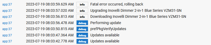

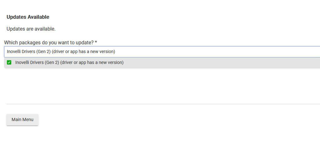

That update seemed to go fine. Then I got an update for Innovelli Drivers this morning that will not update. Logs say "fatal error" and error message says to make sure the app/driver is not in use. I do have the innovelli drivers for my RED switches. But, I do not have the BLUE series installed. But, even if I did, what would be the point of automatic updates if I have to change all the drivers before I can run the updates. I do not think I can choose only the drivers I use out of the Series 2 drivers. Maybe an issue with the update from Innovelli's side?

Logs appear to be generic even though I have all the debug options enabled. If I could get more information, I would.
Tried twice on phone app(chrome?) and once on computer (firefox).
Run a repair on that package, usually that will fix it and update it at the same time.
A Repair is a good idea, it does act as a workaround most of the time.
I don't have a Blue device but installing the driver fails in HPM.
That implies that the two Red drivers I picked from the list install ok, then the Blue driver (3rd of 3) fails.
Without selecting the Blue driver, installation succeeds:
Trying to manually Import that Blue driver yields an error as well:
The identified line2676:
if (nothingChanged)&&(infoEnable||traceEnable||debugEnable)) {
looks to have bad ( ) nesting to my eyes...
changing that line to be:
if ((nothingChanged)&&(infoEnable||traceEnable||debugEnable)) {
allows the driver to install.
In other words, Inovelli would need to update their github code for this particular driver. (The first line of the code looks a little wrong too, cosmetically.
