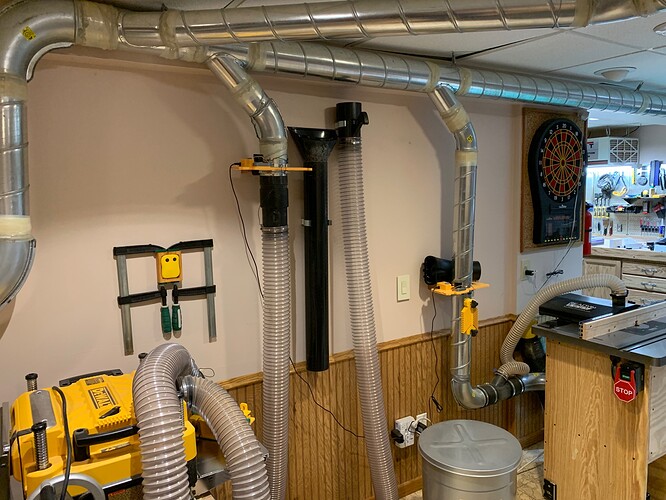

I went with https://www.ivacswitch.com/ivac-for-hobbyists/ and have been very happy, although it was expensive getting it all setup. I went with the contactor and remote switch unit for the dust extractor control, the tool units for detection as well as the remote for turning on the extractor for cleanup, and the 4" blast gates which were the most expensive part. It's great turning on a tools and having the correct blast gate open while my cleanup port closes (one is always open to prevent the dust collector from coming on with them all closed) and dust collection turn on then having the dust collector turning off 10 seconds after the tool is stopped to give it time to clear the dust, then the tools blast gate closing and the cleanup port opening again. I don't have to worry about the dust extractor overloading the switch with the contactor relay on the outlet rather than pulling current straight through the switch.

@Terk, nice setup, mine is all over the place and many of my tools require that I unplug the hose from one machine to connect it to the other one next to it. I'm in the planning stages of our new house (in about 2 years) and the basement will be hosting a large workshop with all the automatic gates and all, instead of in the garage like I have now and prevents people from washing the cars inside (my wife hates going to a car wash).
