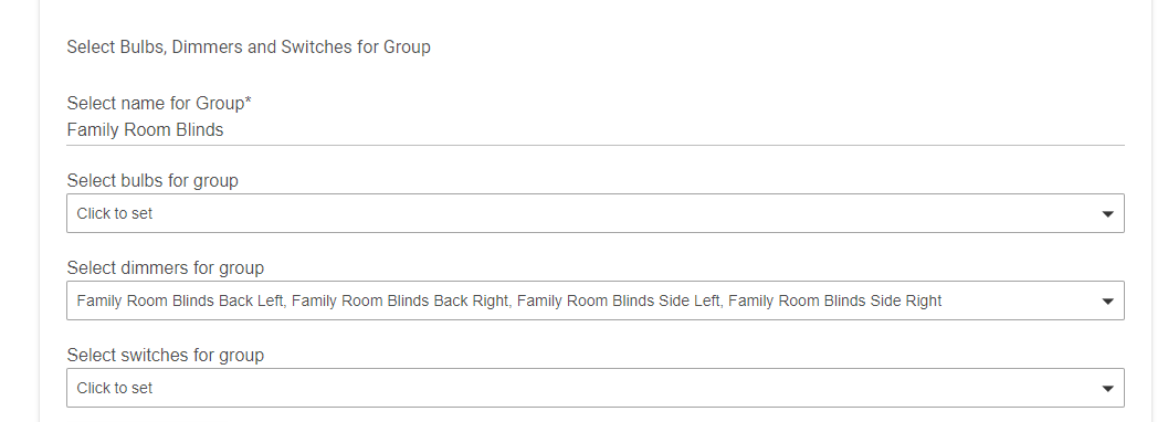

Here you go:
1st capture changing level on Servo 1 only. Moves at the expected slow rate of 3500:
Everything: Received: servo1 0:3500
EX_Servo::beSmart level = 0
EX_Servo::beSmart rate = 3500
EX_Servo::beSmart OldAngle = 180
EX_Servo::beSmart TargetAngle = 0
EX_Servo::beSmart CurrentRate = 3500
EX_Servo:: Servo motor angle set to 0
And this is the capture when changing level of the Group. Moves fast (and per the trace, rate is 1). Note that - per my posts of a few days ago, some servos are R mounted and other L mounted - which would explain why in the trace two servos move to 180, and the other to 0.

In your group did you set the child servos as a "switch" or "dimmer".
Mine are set as a dimmer and travel at the slower rate I have defined (3000ms) in the child device.
Mike

I don't believe there is an issue with Hubduino (servos) as I have various groups of blinds with 3000ms rates set and they all work correctly when controlled as a group from Alexa, Simple Lighting, Hubitat dashboards and button devices using the Advanced Button Controller hubitat app.
Mike
Thanks Dan, it works - both at individual and group level change.
This would be the 3rd change in the child driver I have made. Previously I had modified it to allow for L or R mounted servos, and later added in the Preference so the user can select R or L in the Device page.
In my case I will use Group to control 3 blinds next to each other, and a similar situation in a different room at a later point. I can live with my custom driver as is, but if you want to include all changes in a new official version could be helpful to another soul down the line . . .

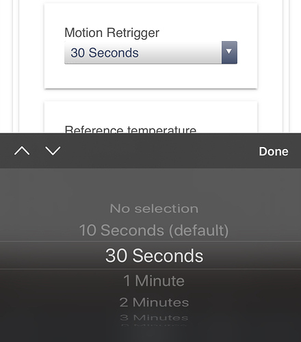

I’ve got a feature request. Would it be possible to add a “motion retrigger” threshold to the motion sensor driver like the one used for the Philips Hue sensor for example?
I’ve noticed that when my motion sensor is sensing motion the HE device is very jittery with many active/inactive triggers. I presume this behaviour is caused by the signal the sensor is sending rather than any issues with any HubDuino components. If there was a motion retrigger option, that would then be able to even out these signals.
I believe that setting for the Philips Hue Motion Sensor is actually sending that 30 second time to the device via a Zigbee configuration command. Thus, the device is actually responsible for respecting that setting, not the Driver.
What type of motion sensor are you using with HubDuino? Many PIR sensors have an adjustable timeout and a jumper which configures the output signal (either as a pulsing square wave, or a constant signal to indicate motion or lack thereof.) Perhaps you could simply adjust the physical sensor?
I've written a couple of motion sensors with Arduino and ESP32's. I implemented the timeout there because it was very chatty.
