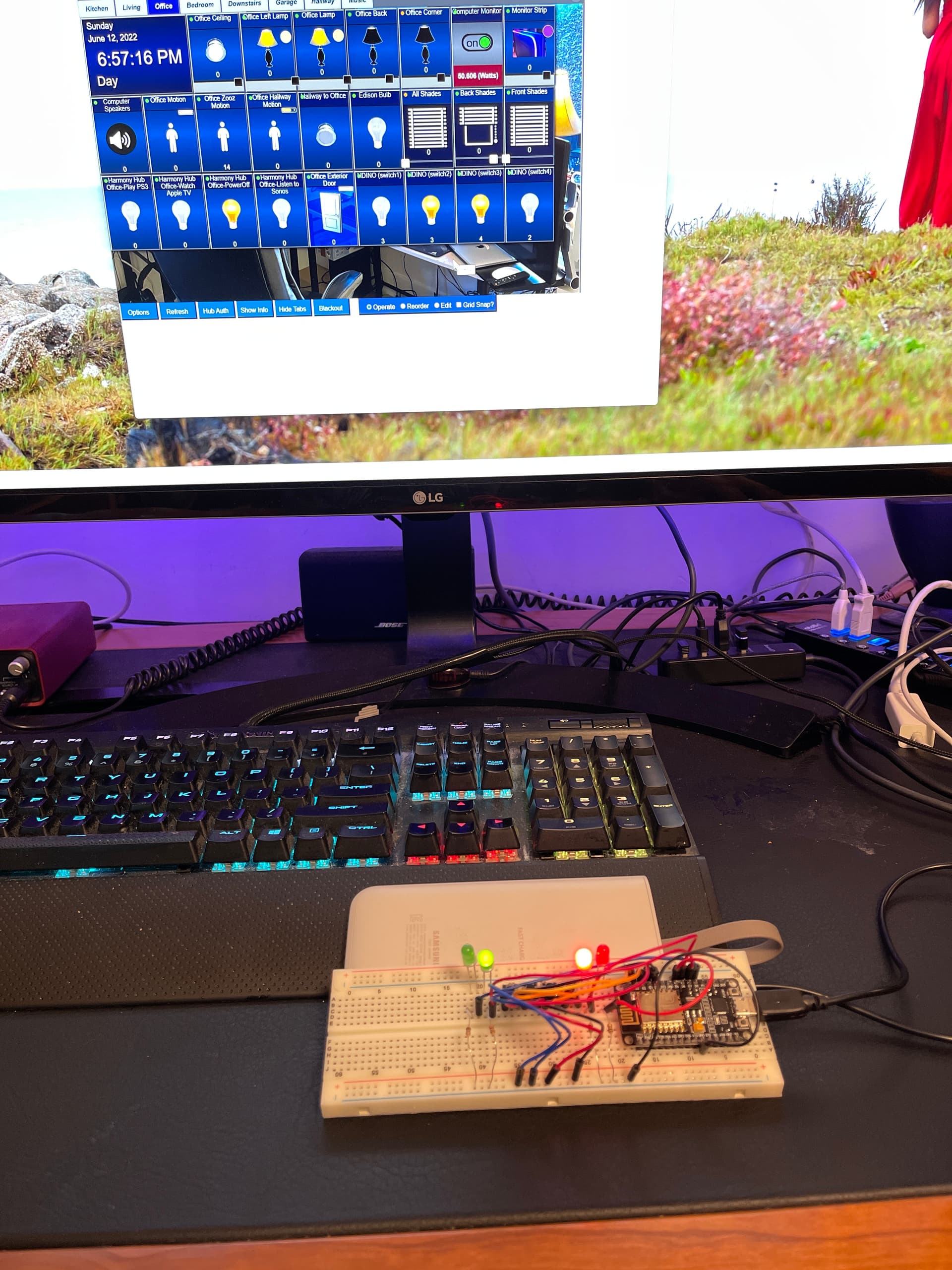

After many years of being away from this I got Hubduino installed and working and integrated into my HousePanel - so super cool. Thanks @ogiewon Dan. Here’s a photo of my bread board integration. Will package it up later nice and tidy.
