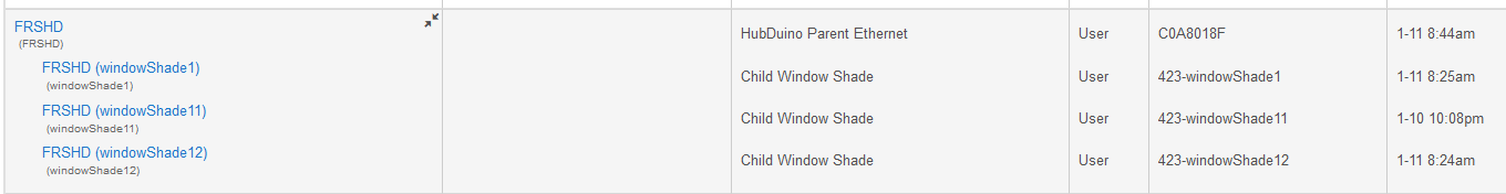

What causes multiple child devices to be created when there is in fact only 1 ?
It appears you named it three different things.
windowShade1
windowShade11
windowShade12
Look and the child devices’ device network IDs.

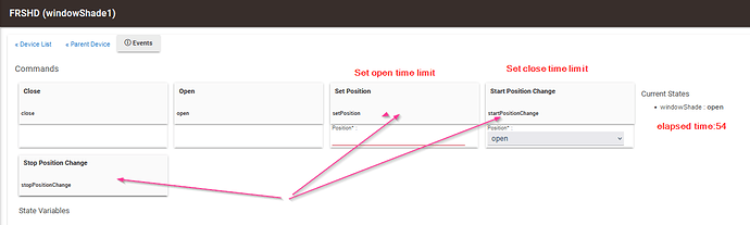

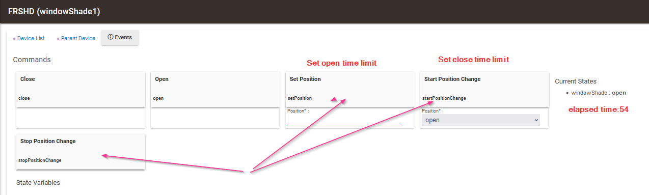

does anyone know how to get rid of some of the command boxes (they are coming somehow from adding
capabilities window shade;
for example Set Position and Start Position Change ?
Those are added automatically by the Hubitat platform. There is no way to remove them when using standard capabilities.

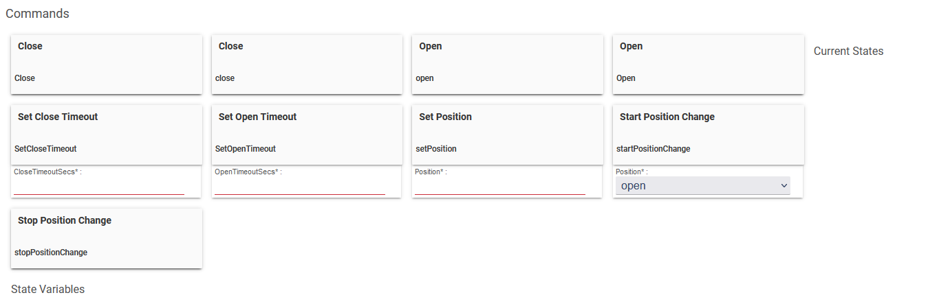

making progress but a few more q's

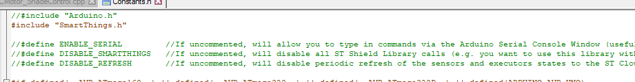

i dont think refresh() is getting called in the arduino code even though

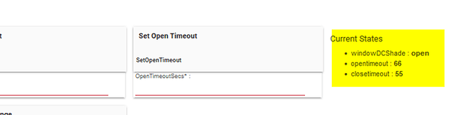

so I could have some information for the device ( in yellow)
but if I refresh the browser those go away
is that right? is that a function of refresh() not running?
thanks for all the help
Looks like you have created some custom attributes, but did not declare them as such in your custom driver. If not declared, they are temporary. Also, they will not be visible in RM as a custom attribute.
The ST_Anything’s internal refresh happens automatically, unless disabled in constants.h as you have shown above.
For things like “timeouts” that I assume you want sent to the microcontroller, you should probably implement them as a user setting, rather than as an attribute.
Ah...i had them as attributes but had the wrong spelling....so I put the right names
what I didn't expect is that I had to add windowDCShade also for it to be persistent
my goal was to be able to set the value BUT also get feedback from the arduino that it was changed ....

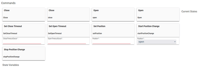

my next issue is that on the dashboard... it used to show a very cool shade and when open it would show a sunshine and then when I closed it ...the shade showed it closing
but now it shows
I have picked the shade template in the dashboard and the device has "window shade" capabiity...
so not sure what exactly ties it together
You’ll need to make sure your device driver updates the Window Shade capability’s attributes. If they are blank, then the dashboard won’t have any data to display.
OMG, thanks so much .......your experience and knowledge knows no bounds!
Yaaaa, I now have the cool icon of the shades now and everything seems to work.
