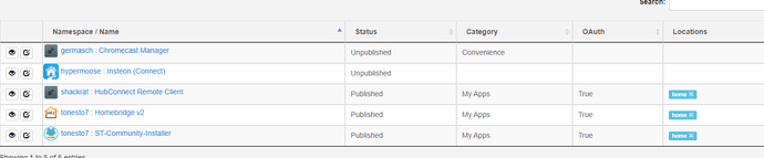

somewhere i'm missing a step ...i screwed it all up the other day so started from scratch ..the hub is connected , i have devices selected, i have the handlers installed but the devices won't come over to smart things
Got the apps installed on the smartthings remote hub? You mentioned the device handlers but nothing about the app piece.
yup
i am connected just nothing is moving over
Thanks @lewis.heidrick it just hit me today that you meant the actual insteon connect app on smartthings...everythings working good again!!
