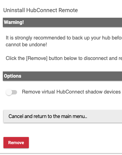

I have uninstalled this as no longer need but on reboot, it looks like its still present
do do you remove app which are no longer installed?
When you wish to entirely remove HubConnect:
You should click that Toggle for "Remove virtual shadow devices..."
Otherwise, you'll have to go through and manually remove them.
thanks, it was a device lingering , i used the big red button on the setting page!

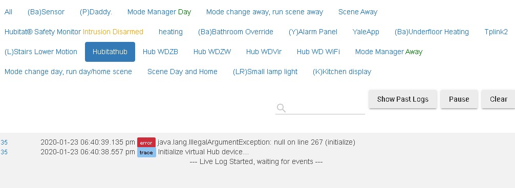

Client error:
Not Connected
Error: Instance in use by another hub
I am stumped.
There is a bundled driver to transport these between hubs. I don’t know if it fully supports them as I do not use global vars, but those who have tested it say it works.
RM doesn’t offer any sort of API so the integration does its best to work around this limitation.
The server will not allow you to set up a second instance to the same hub (and IP address). This error is letting you know that the server already has a connection configured to communicate with that hub.
I would double-check your other server instances to try to locate where the conflict is happening. You can run a technical support report to see all of your system data. That will help to track this down quickly.
The next release of HubConnect will do a much better job of reporting the source of these conflicts.
