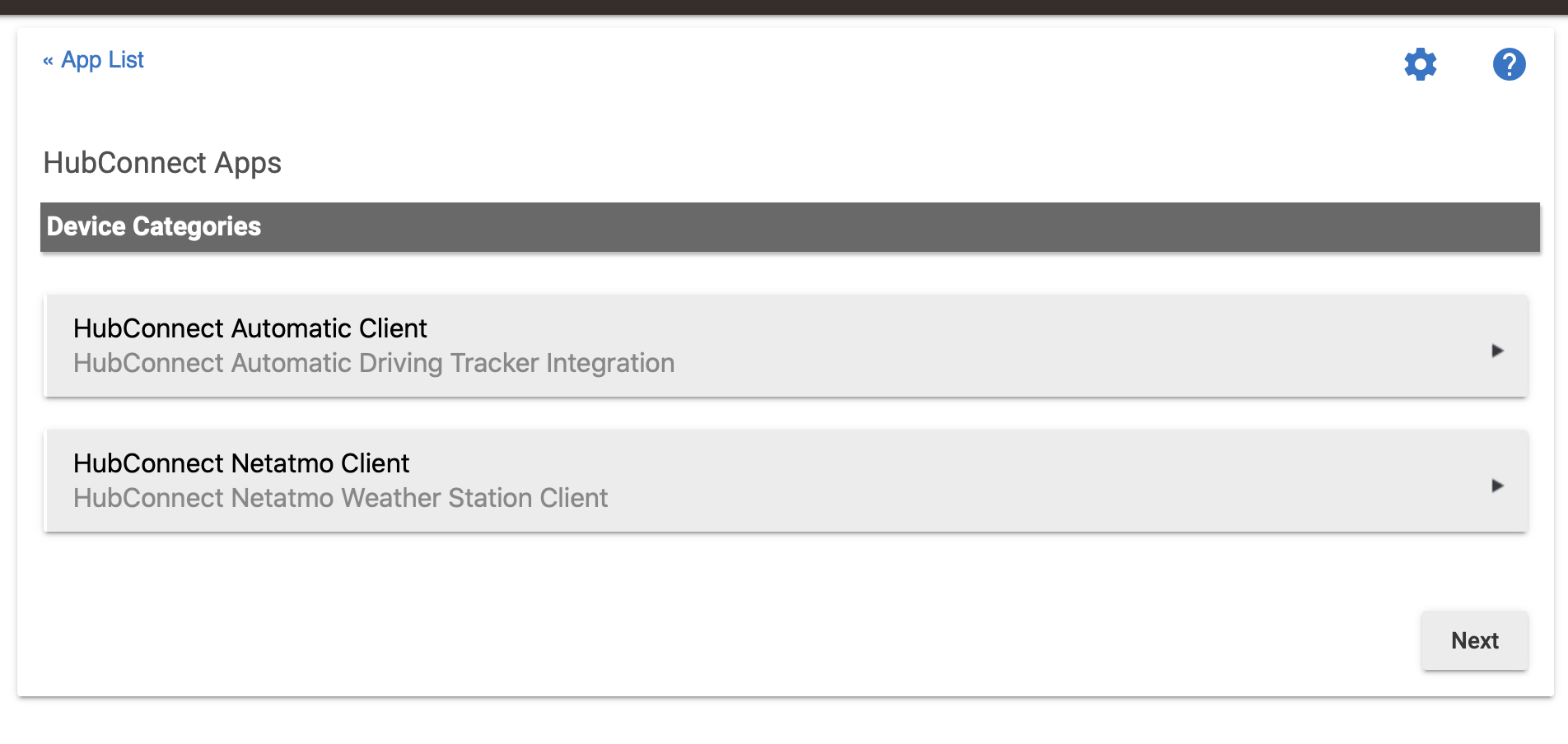

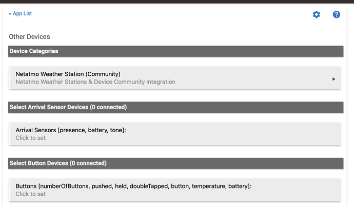

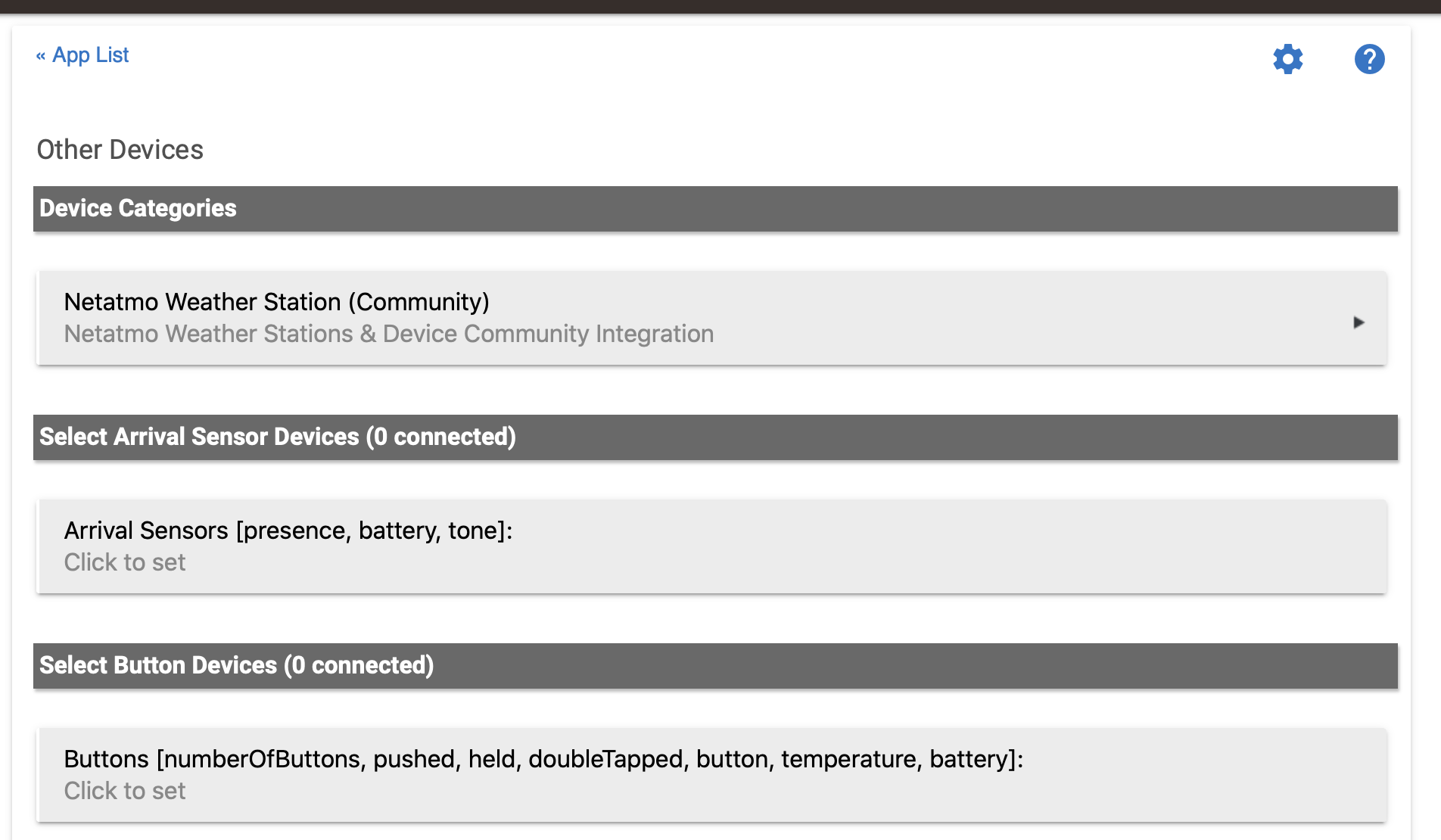

Just a quick update for those waiting on 1.7 (like the beta team)...
I'm putting a few more UI touches on the device selection code... I have made it hierarchical so it's better organized, and not as cluttered as it was before.
The long game here is to make it so other community apps/drivers can integrate more seamlessly than they do now. :slight_smile:
