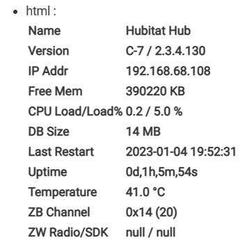

Also, I am getting the error below?
What is showing in the html attribute (suspect you may be missing the template file - https://raw.githubusercontent.com/thebearmay/hubitat/main/hubInfoTemplate.res needs to be copied to the Settings | File Manager if it's missing)
Please see below:
Summary
Looks like it was a momentary issue. You should be okay, but if it keeps occurring let me know.

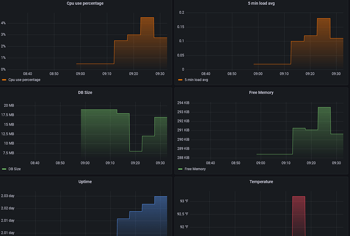

So I wanted to get some stats from the hub info driver into influx/grafana but felt all the node-red stuff was a little overkill for the task.
I managed to get it done thru webcore. Here's the piston and a early screenshot of the dashboard. It took a little figuring out how to use the attributes. Turns out they need to be stored as variables. You could probably use this to log any sort of stats that isn't supported by the influxdb logger app.
