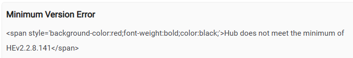

@thebearmay, I updated my hubs to 2.4.0.119 today and noticed this on the preferences display page:
I suppose this is just cosmetic, but I thought I would pass it along.
Looks like you’re on a Beta release of the firmware - waiting to see if they keep the code the way it is or if I need to make an adjustment.
Also pushed a new version of the driver this morning to fix a typo in the minimum version check.
