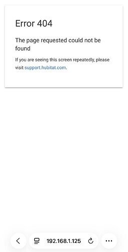

And if I try the endpoint manually, I get a 404
Try this as the else branch:
 else {
        httpPost(
			uri: "http://127.0.0.1:8080",
			path: "/hub/reboot",
			headers:[
                "Content-Type": "application/x-www-form-urlencoded"
            body:[rebuildDatabase:"true"]
    	) {		resp ->	}
note that it is a POST (not the GET that your browser uses) and there is a Content Type and Body. If you want to test outside of the code you'll need to use something like curl or maybe postman to send it as a POST.
Cheers, I’ll take a look tonight after work.
This worked! Thank you mate. :pray:
